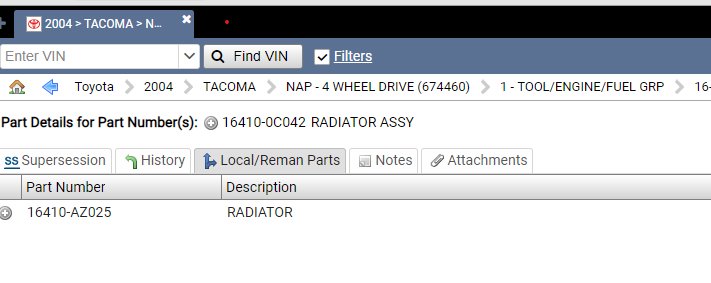

    Can anyone tell me what the correct part number is for an 04 Tacoma 3.4l 4wd Auto.
    Depending on where you look there all different. Some Toyota dealers say 16410-AZ050 is correct while others say 16410-AZ025. Which one is it?

    If you're thinking about buying a TOYOTA radiator, beware of what most Toyota dealers are now offering/selling.
    Over the phone from the parts person at my local dealer, heard that 16410-AZ___ radiator models are Southeast Toyota parts (not Toyota OEM). They are parts that dealers are now using to replace 16410-0C___ (Toyota OEM).
    I paid $200 for 16410-0C042 at said local dealer, and received 16410-AZ025 instead. I asked my dealer why I received the cheaper part, and they said the original was discontinued.
    I inspected said AZ radiator (appeared cheap), found no Toyota markings (maybe I didn't look hard enough), and returned it.
    Went to AdvanceAuto and picked up the same radiator locally for $130, after discounts. ("LIMITED LIFETIME REPLACEMENT").
    Below is a link showing said radiator 'options'. Pretty representative of most online dealer selections.
    https://www.sparksparts.com/search?search_str=radiatorassembly&make=&model=tacoma&year=2004&page_id=&page_url=
    All this being said, I'm sure I'm partially incorrect and my dealership is partially incorrect and somebody isn't understanding something somewhere that made this happen.

    16410-07061 (Size: 20.63x24.63x1.25 in; Alternate: 16410-AZ050)
    1995-2000 3.4L A/T 2WD Excl. Pre-Runner
    16410-0C014 (Size: 18.75x24.63x1.00 in)
    1995-2004 2.4L M/T
    16410-0C024 (Size: 18.75x24.63x1.00 in; Alternate: 16410-AZ039)
    1995-2004 2.4L A/T
    16410-0C032 (Size: 22.75x24.63x1.25 in)
    1995-2004 2.7L M/T
    1995-2004 3.4L M/T
    16410-0C042 (Size: 22.75x24.63x1.25 in; Alternate: 16410-AZ025)
    1995-2001 2.7L A/T
    1998-2004 3.4L A/T 2WD Pre-Runner
    1995-2004 3.4L A/T 4WD
    16410-0C071 (Size: Unconfirmed but probably also 22.75x24.63x1.25)
    2002-2004 2.7L A/T
    The part numbers in bold are the factory radiators, the alternate part numbers are what Toyota calls "MVP," or Market Value Priced radiators. They are typically made in China by some cheaper radiator manufacturer "to Toyota's specs," and include the same service replacement warranty as the original service parts. That said, a lot of the original radiator part numbers are no longer available, so the MVP radiators are the only option from Toyota. Additionally, you can of course use the automatic radiators in a manual truck, just don't use the cooler ports.
    It looks like 16410-0C014, 16410-0C024, 16410-0C032, and 16410-0C042 are no longer being produced. You can probably still find some Denso stock from places like Rockauto, but it looks like Denso has also stopped selling them as well.
