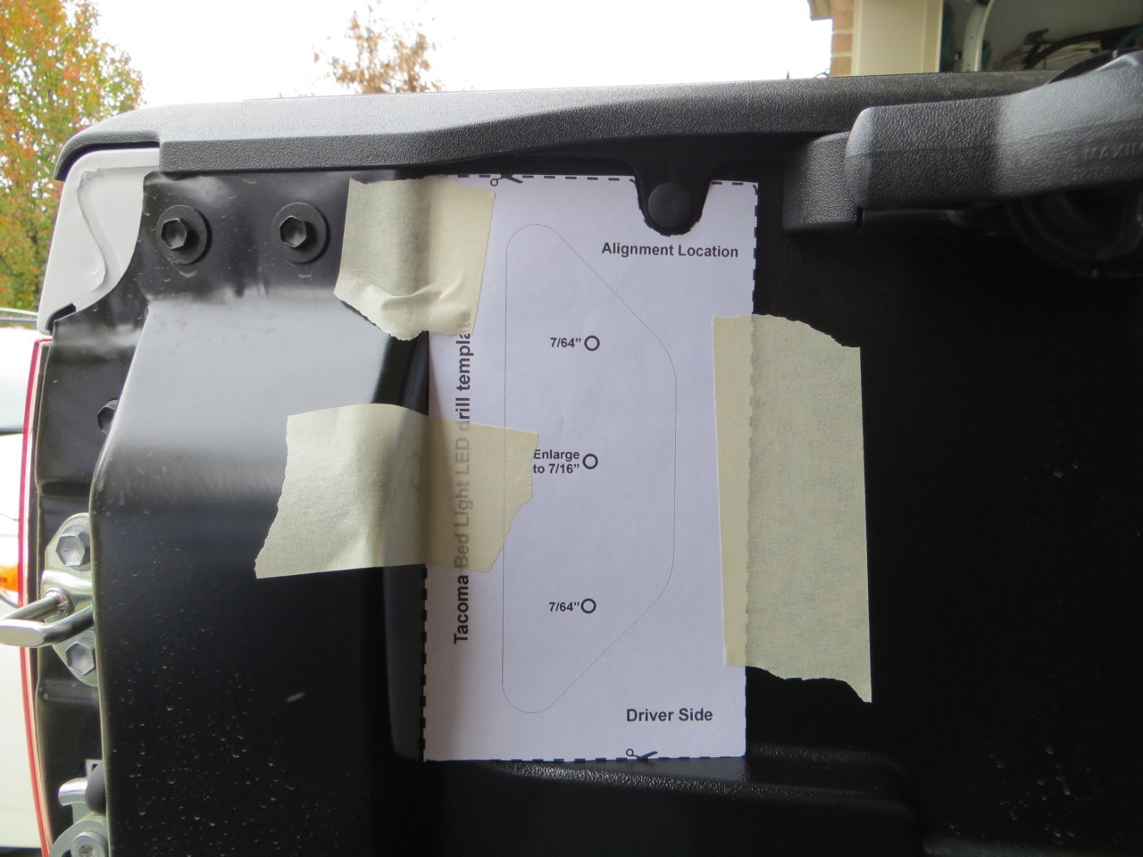

    Mine were bought 3 years ago from North Miami Lexus on a group buy here on TW if I remember right. At the time they did not come with the templates for mounting. I think I found the printable templates on line at TRDParts4u. Make sure if you have to print them that you select "actual size" on your printer. They may already come with them these days....I don't know. The lights are the same between the Taco and Tundra. But I would imagine the templates are different.
