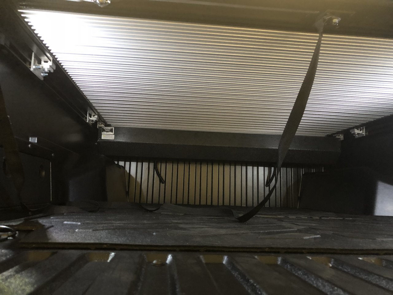

    This is the kit i bought
    https://www.ebay.com/ulk/itm/282228230864
    Its perfect if you have a bed cover. I have 2018 TRD OR, I have it wired to the cargo light switch so it turns on anytime you unlock, open the doors and can be manually turned on via the cargo light switch. You can tap into the cargo light switch right under the driver side kick panel. It really doesn’t matter which light kit you get or even LED strips, as long as you wire it to the cargo light switch it will work great. Get the cheapest one you can find that is waterproof. Also this is not related but I might as well throw this in since were talking about lighting up dark areas, Amazon sells an LED under hood kit with a hood pin switch for $30. Comes in handy to light up your engine bay.

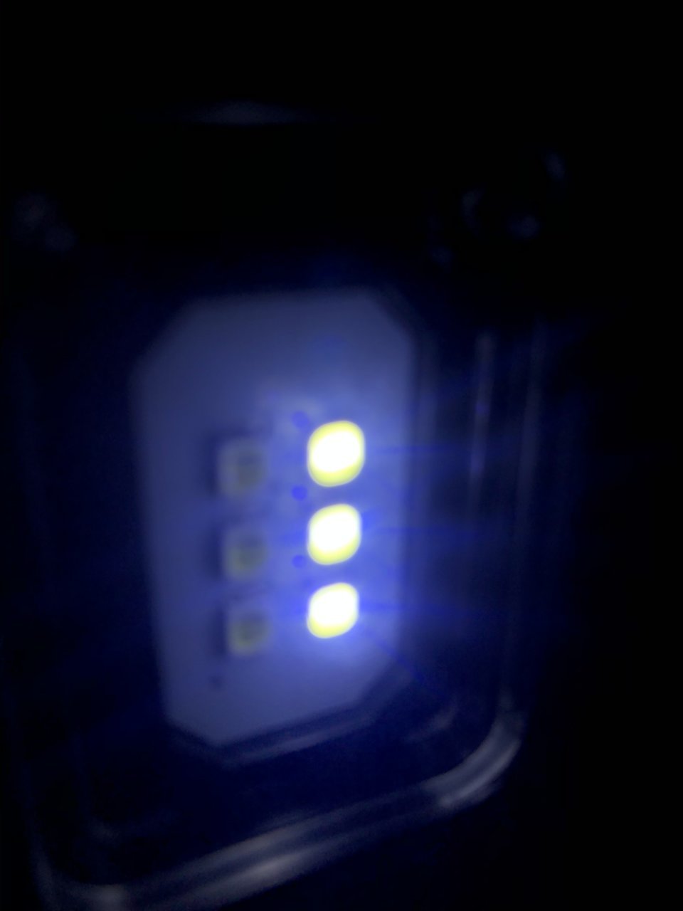

    Bulb, module, board... same thing. I have them in my truck. One doesn’t work at all and only half the LEDs in the other work. Like that when I got it. They turn on when the dome light is on. I’m looking for either a cheap replacement bulb or doing strips all around as mentioned.7C3A9521-933E-4F29-BDE0-BA7AD21683AE.jpg
