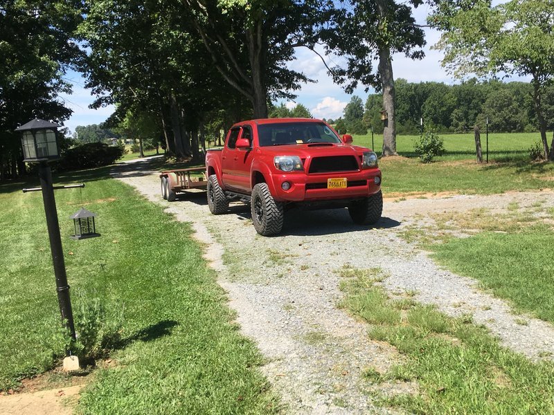

    This is 4" with 33-12.50s ... Love it and isn't over the top... And dependable (have a vibration issue right now at 60mph that I can't pin point yet but once I do it will be 110%)
