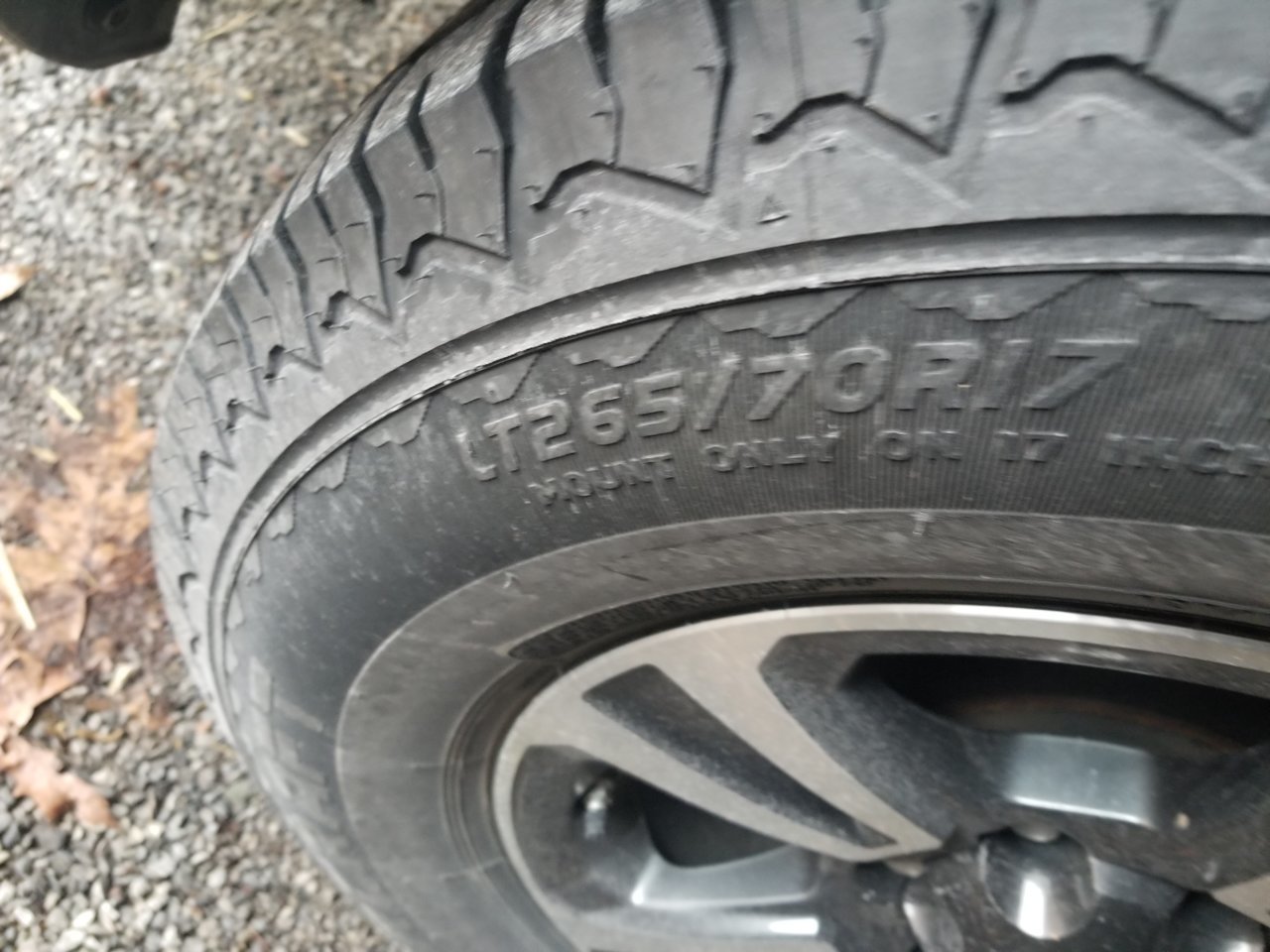

    Stock tire sizes (fits regardless of lift size)
    17" wheels - 265/65r/17
    16" wheels - 265/70r/16
    Largest tire without lift (preferred)
    16" wheels - 265/75r/16
    255/80r/16
    17" wheels - 265/70r/17
    255/75r/17
    3" lift and/or leveling kit
    16" wheels - 285/75r/16
    255/85r/16
    17" wheels - 285/70r/17
    255/80r/17

    I can confirm, 265 70 17 fits great and was cheaper then the same tire in stock size
