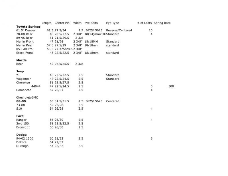

    Been searching around, but cannot find the measurements:
    What's the eye-to-eye measurement of the factory leaf springs for the 05-15 Tacoma's?
    Thanks!
    EDIT: You know what, I think I answered my own question, but I think this will be helpful for others too:
    431436d1238045690-leaf-spring-dimensions_0cd404a03334380d04f470c632ed4bd0a10f58d8.jpg

    And another helpful resource (thanks ih8mud):
