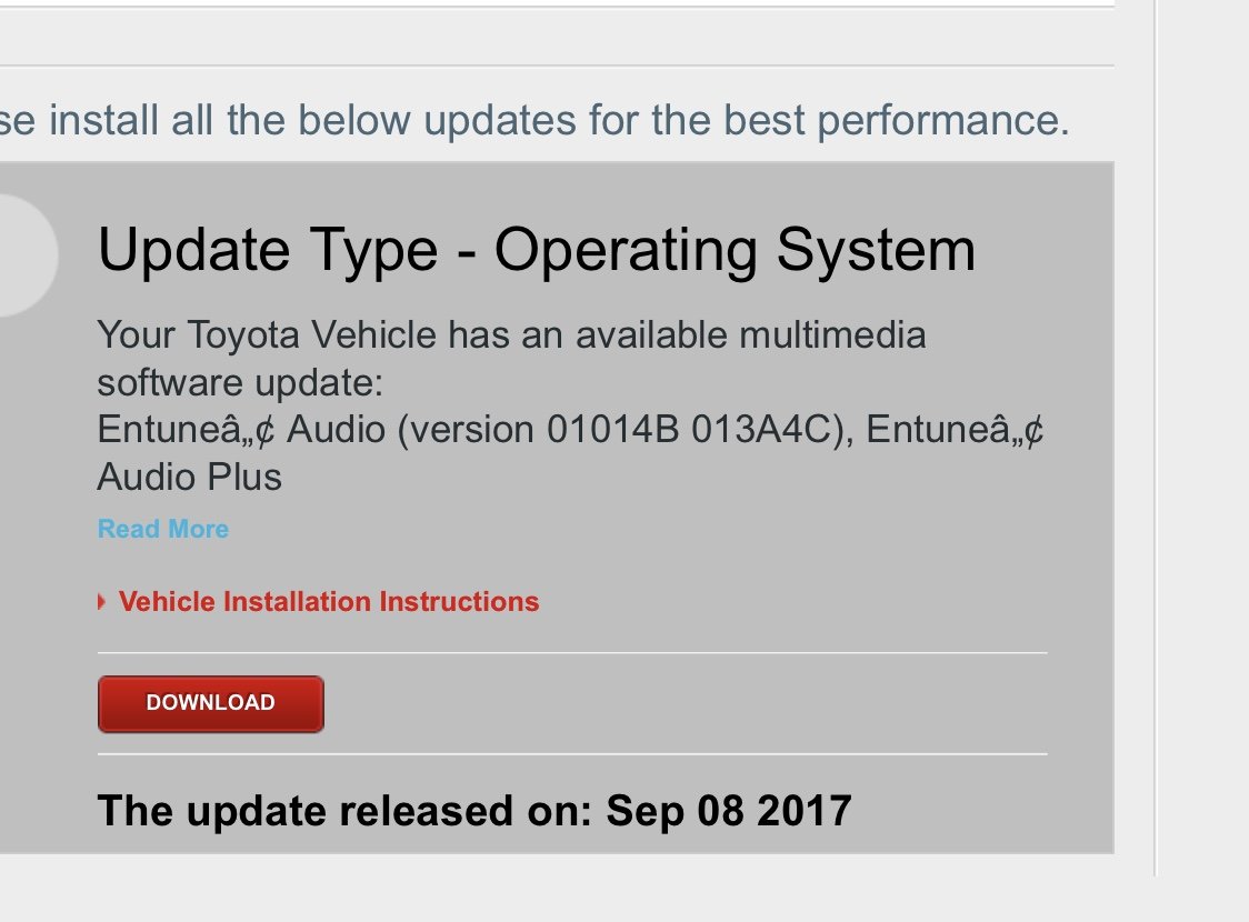

  20. Jun 26, 2020 at 12:15 PM
    #40
    danwray
    danwray Traitor
    Aug 21, 2018
    #263556
    287
    Dan
    Kentucky
    2021 Ford F150 XL 4x4 2.7 ecoboost
    The hard number? I'm not sure, this is what it gave me IMG_20200626_104800.jpg
