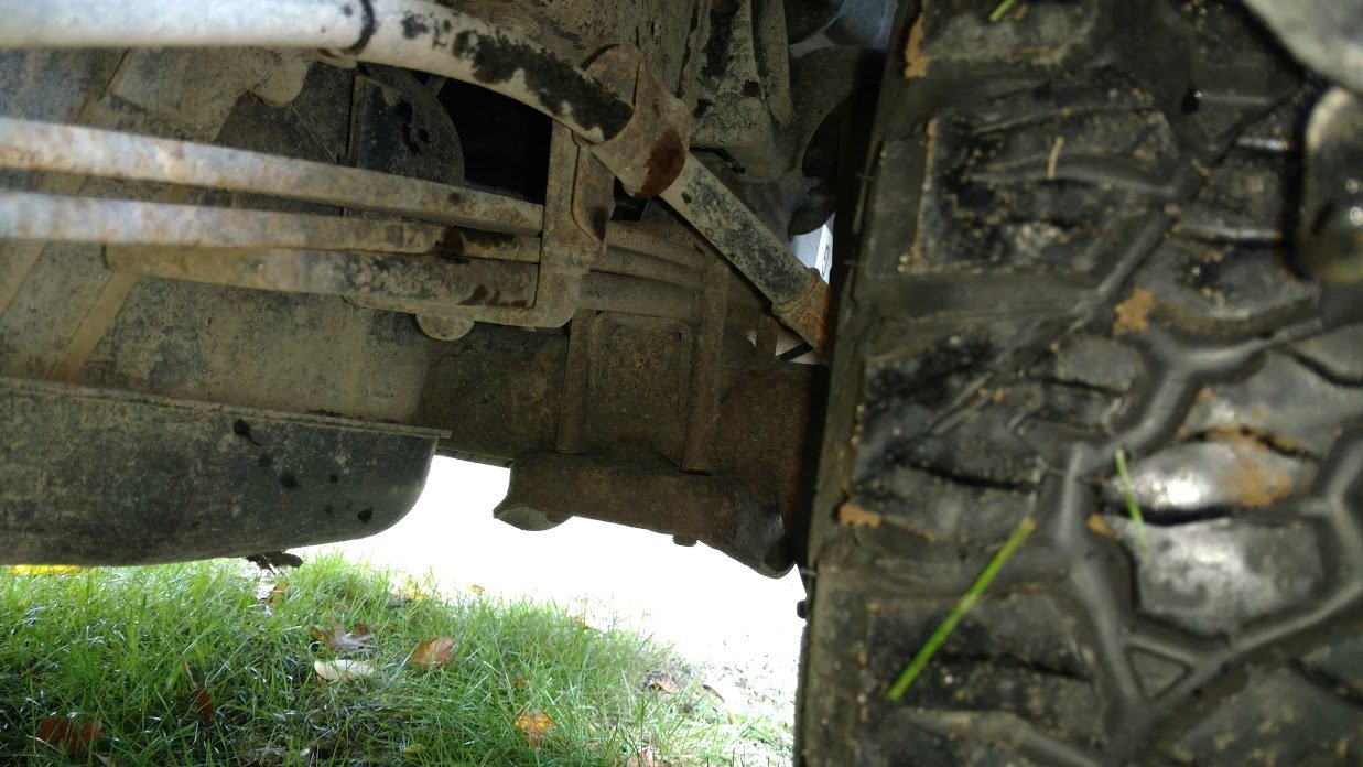

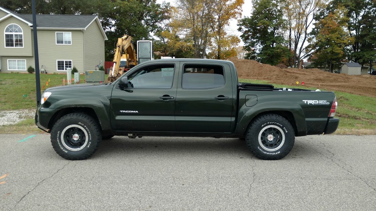

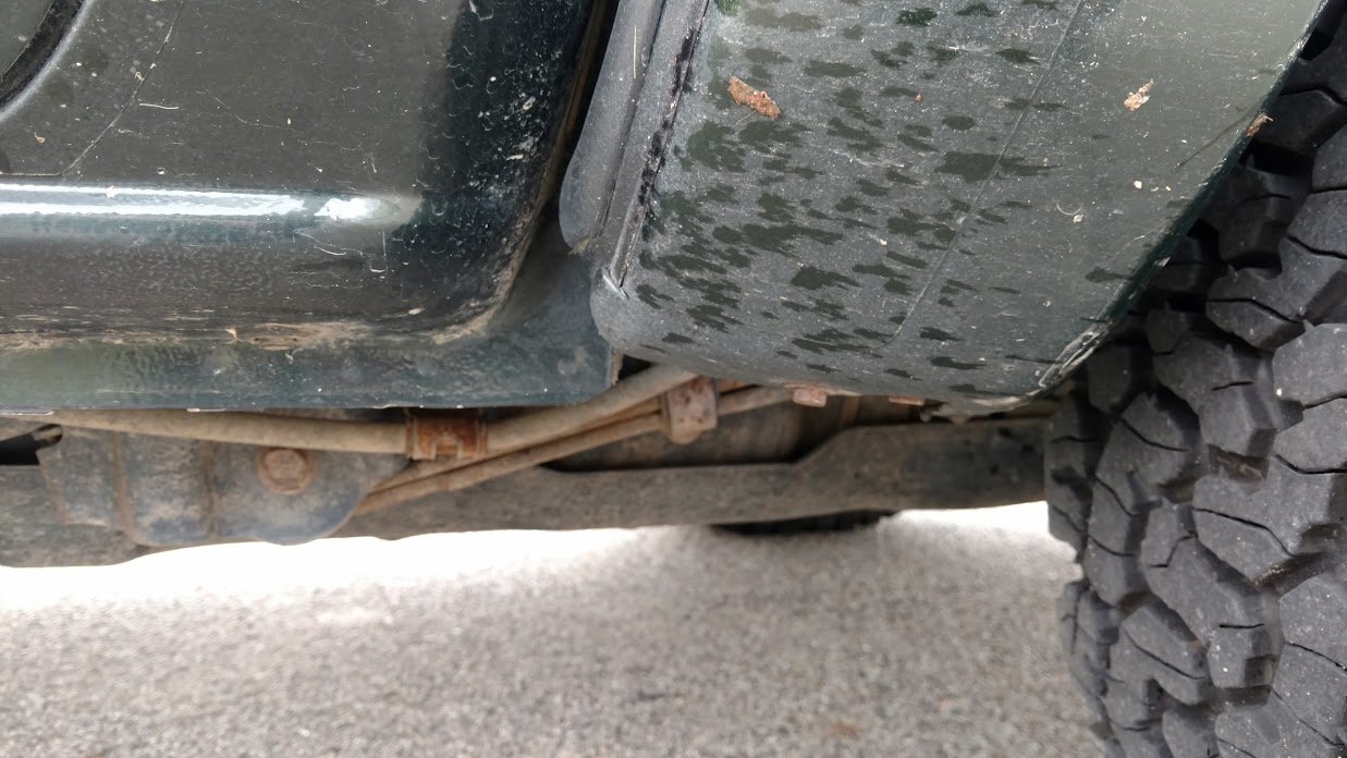

    That's my experience also. My springs are basically shot right now and I'm replacing my 2-leaf pack with a 3-leaf pack from a 3rd gen. This was with 1,120 lbs of water-softener rock salt in the back. You'll notice that is slightly over the actual payload if you count me as a passenger (250 lbs). As I removed bags I waited to see when it got off the bump stops and it was only at 800 lbs in the bed, with me obviously outside the truck, that it came off the bump stops every so slightly. You can see in the second picture with the full weight in the bed still that I'm both on the bump stop and fully spread over the overload leaf.
    The load handling capacity of these trucks is a joke with certain leaf packs. I believe newer 3rd gens have the same TSB setup the 2nd gens had, and the 2-leaf packs on the TRD OR is just not meant to handle any load. I get significant squat now while carrying a heavy cooler, couple cases of water and the tongue weight of an unloaded trailer.
    My advice is to do it, even though the truck isn't really up to it, and then replace your leaf pack with something more substantial like a Wheeler's HD leaf pack, OME Dakar, or another stock pack with a 3-leaf AAL (which I'm going to do, just because I don't want to go too high or make it feel quite as rough as an HD truck)

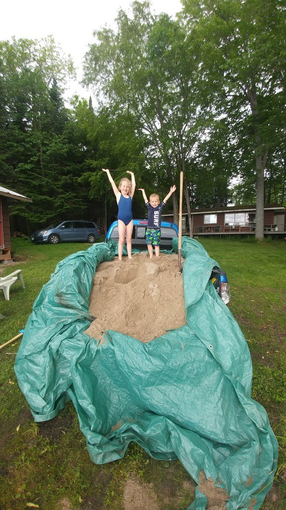

    Here is a yard of beach sand and it was draging ass all the way ..... But I took it slow and no adverse effects. A yard of top soil does the same. 20170707_131639.jpg
