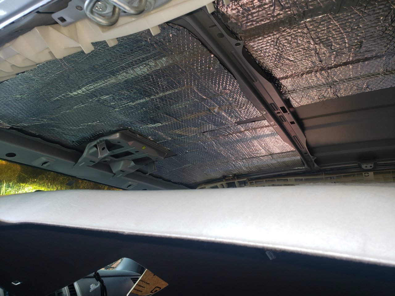

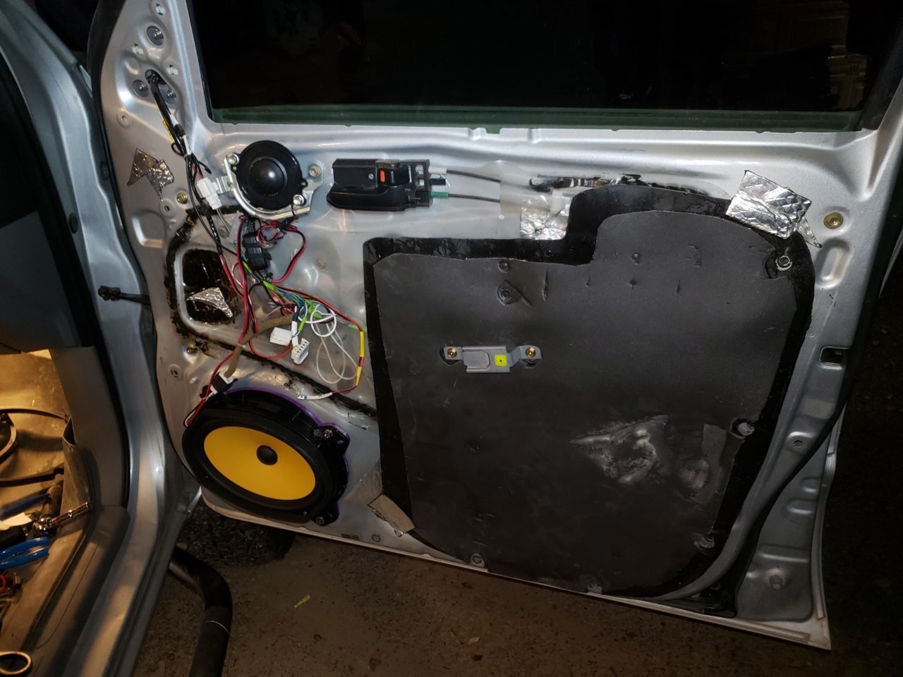

    Haha.... the thread may be dead, but the truck isn't!
    50 pounds of sound deadening crap later, the cab is notably quieter, and the doors have a nice solid thud when you slam them.
    Also I eventually managed to fix all the water leaks, including:
    - both "door condoms"
    - air intake at cowl
    - 3rd brake light
    - rear window drains
    - air vent behind back seat <-- this one was actually the main culprit!
    Cheers y'all
    Edit.... for what it's worth, here's what the doors wound up looking like, after I also decided to upgrade the speakers the other year:
