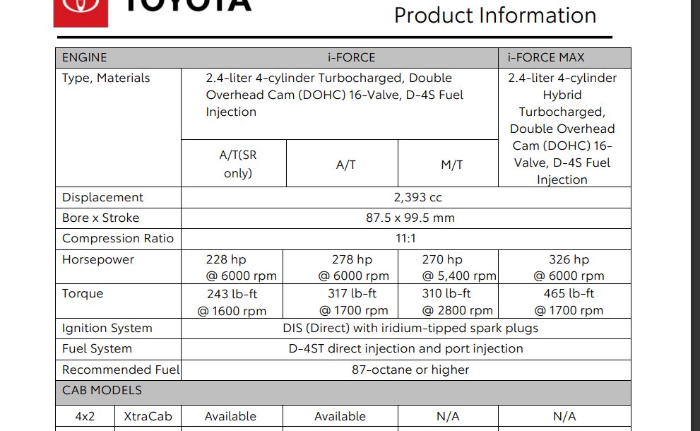

    2024 Tacoma production info pdf that was released a few days ago. MT gets higher torque curve and lower top end.

    I want to sue Toyota for false advertising, clearly it's not a 2.4L it is a 2.393L motor! Stupid lawnmowers.

    Closer that the Tundy that gets called a 3.5 sometimes. At least this one does work mathematically...

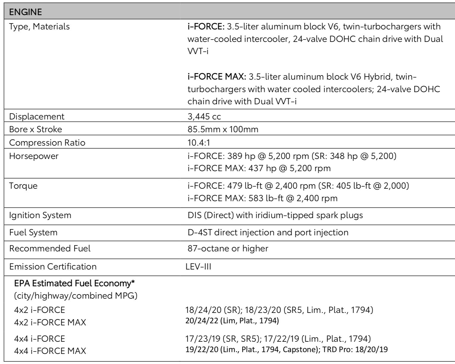

    Tundra is looking better and better, even the detuned SR which has 1885# payload and 8300# towing in the DC6.5, base price of $43K for the 4WD.

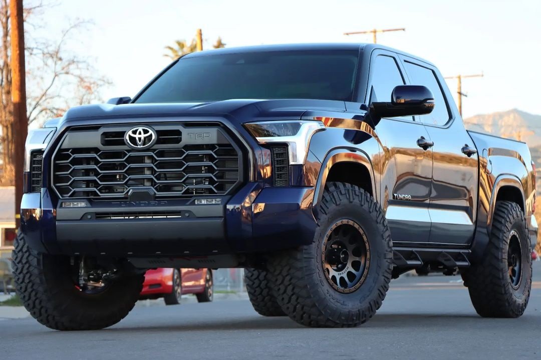

    You need to go test drive a Tundy, there are niiiiice. It really isn’t that much bigger, actually the bed felt kind of small to me. Only thing I don’t like is the grill, but I spend more time driving than I do looking at it.

    Grille doesn't faze me. I don't like it in certain colors, but that's an easy fix IMO.

    If you color code the redneck mustache chrome surround trim, it isn’t too bad.
