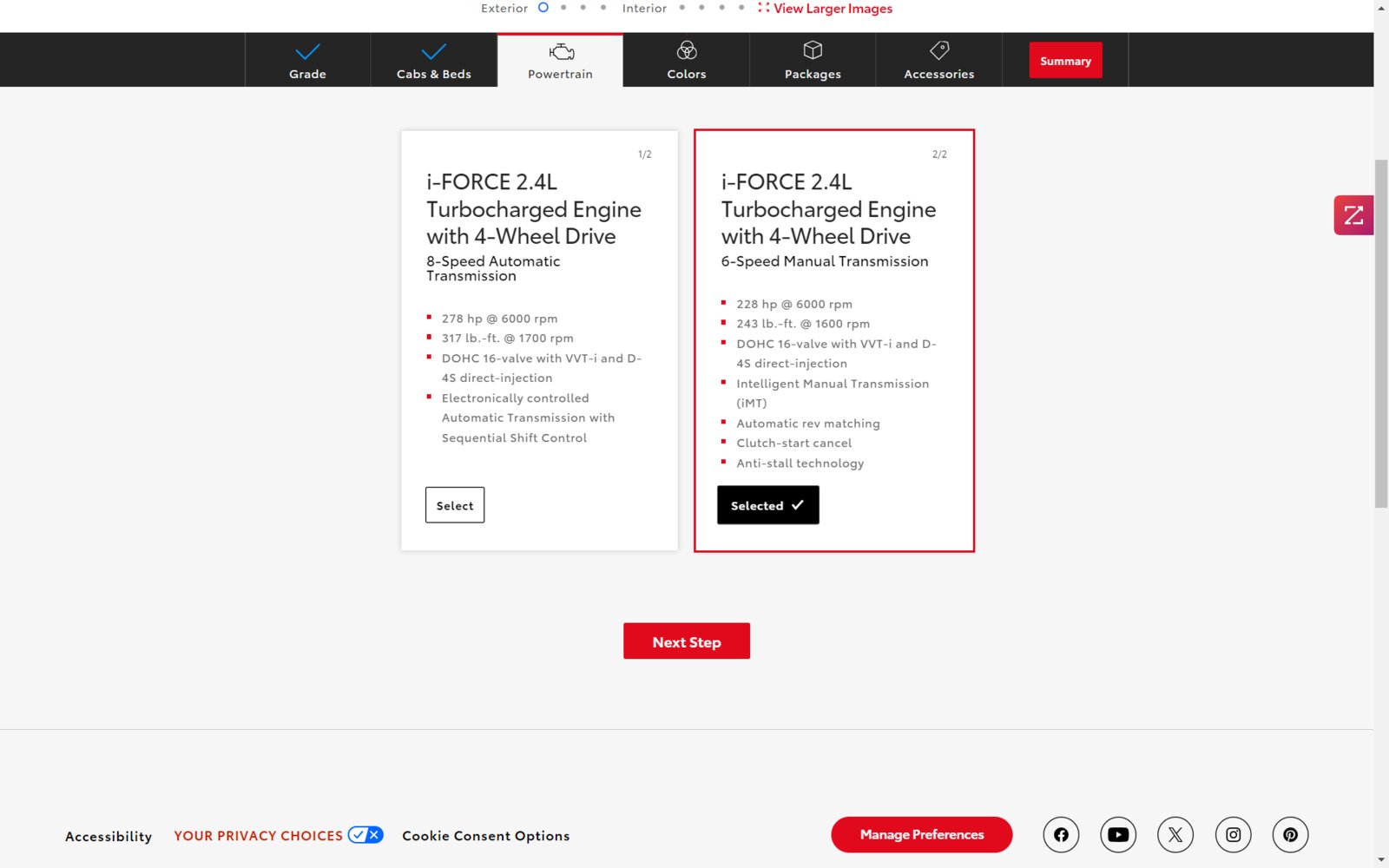

    I'm seeing a 50 HP Drop from the AT to MT option...that's huge and will certainly be a turnoff for anyone who normally wants a MT.

    All this talk about “improved tq”…
