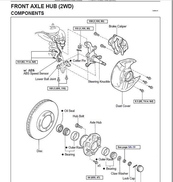

    The nut that says sa-19. Some say 30mm. I think the 4wd is 35mm. I want to pick one up before I get home so I do t have to take it apart and then have to go to the store to pick up the socket. Please help. Thank you all.

    It’s 30mm
