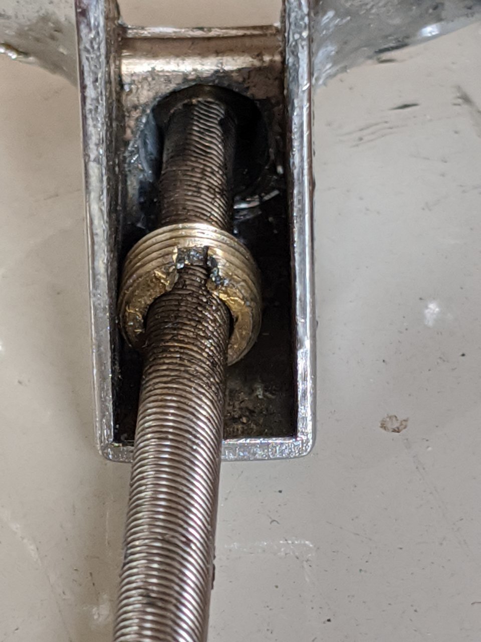

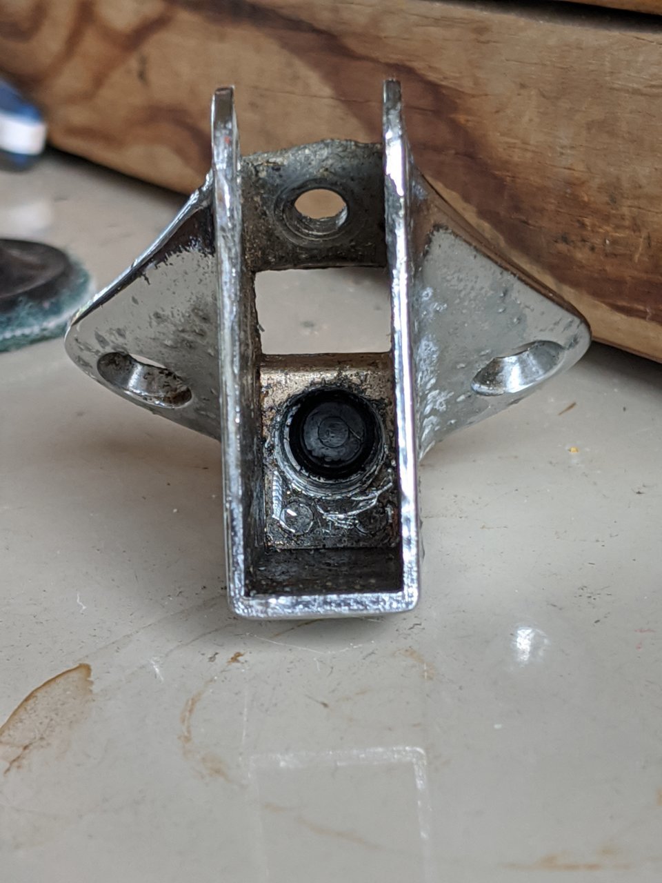

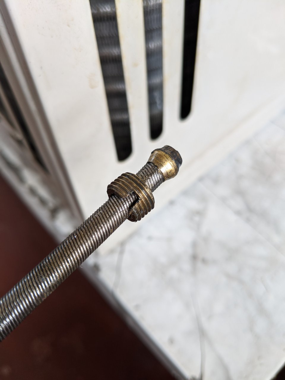

    Doing some work on my boat and I have a spot light that tilts and spins. The light doesn't spin anymore because the brass nut in the picture was loose. I managed to get it out with some needle nose pliers, but doubt that I'll be able to get it tight enough when I put it back together.
    A typical spanner wrench won't work as that sits in a void about an inch deep, so I figure something like a socket would work best.
    Any ideas?
    Thanks

    Probably had some one-off tool to get that in. Could maybe use some 90 degree needle nose pliers?
    Or these circlip-type ones: https://www.ebay.com/c/923217275

    This isn't a one -of tool. The light was made be a company called Sparton.
    My bet is they had something similar to a cable TV installers connector nut driver or hollow straight through for this flex cable to pass through. It needs to be thin walled as well. There isn't a lot of space...
    If I had a lathe, this wouldn't even be a question.

    Spanner wrench.

    I've never seen one with tips as long as I need.
    But yes, that was my first thought as well.

    Just because it's made by a manufacturer doesn't mean they didn't have custom tooling made. It happens all the time.
    However, something like these (https://www.mcmaster.com/wrenches/drivers-for-spring-plungers/) might work.

    @buyobuyo I definitely agree with the custom tooling. I was hoping to not have to go the custom route though.
    Such is life...

    Get a piece of metal pipe and make a tool.

    That's the plan. Although I was planning to donate a socket for this.

    How will a socket work? Is the tube flexible enough to get a ratchet wrench on top of the socket after you cut the sides of the socket off? Sounds like a lot of work to make a socket fit.
    I think it will be easier to get a small 3/8 wrench or whatever size fits, drill a small hole at the tip of each side on the open end. Make the hole just large enough for a metal dowel (even a part of a metal coat hangar will work). Then tap the dowel in the hole with about 1/8” protrusion.
    Or just clean it up well and thread it in using a flat head screwdriver in the opening. That would probably get it tight enough.

    The socket works by having it meet my good friend, Mr cutoff wheel. Make a few cuts so I have the fingers to tighten that nut. I also need the cable to slide through. Vice grips on the socket will let me tighten it up nicely.
