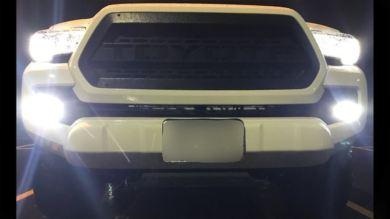

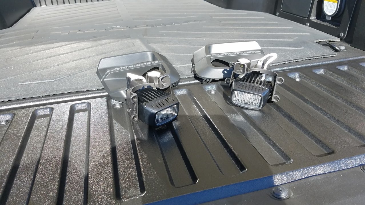

    Just out of curiosity where did toyota set them at, if any of you TRD PRO peep could pop off your rigid plastic bezels and look that would be appreciated. I just installed them yesterday and look fine but might just be slightly off, kept looking st them last night...
    I adjusted it where I can see 2-3 threads left when I tightened it.
    If anyone was curious what they looked like if they wanted to burn 500...and no they aren't anything extremely bright vs LED bulbs, even probably factory fogs. I just like OEM stuff and DOT approved lighting.
    Thanks

    They don't look evenly adjusted by that picture

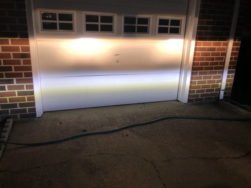

    Rough rule of thumb with fog lights- Back up 15 feet from a wall or big door. Set the very top of the fog light beam even with the bottom of your low beam.

    Does this look about right to everyone? About 15ft away...still curious about how a TRD Pro look like doing this.

    @oscolivar1
    That looks pretty good to me. You shouldn't blind anyone setting.
