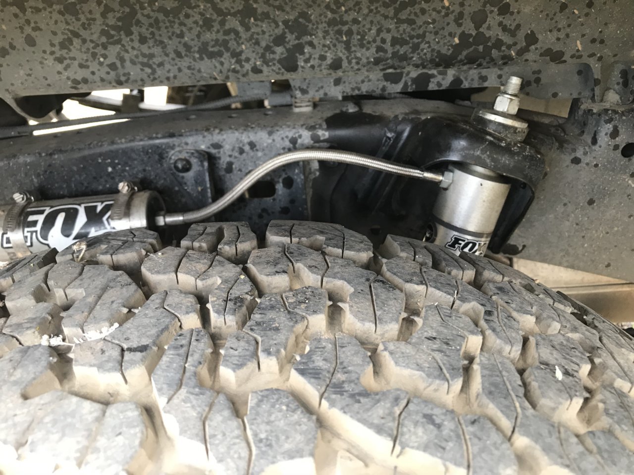

    Moved my remote resi from shock to frame because it got hit. Didn’t clearance the shock mount for the hose which obviously got pinched when flexed out. Ran the rest of the trail with no shock oil it sucked and cost me a couple hundred bucks.BD444B40-A729-4E3D-846E-E14458469492.jpg
