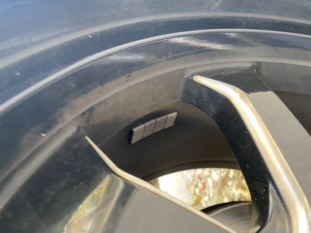

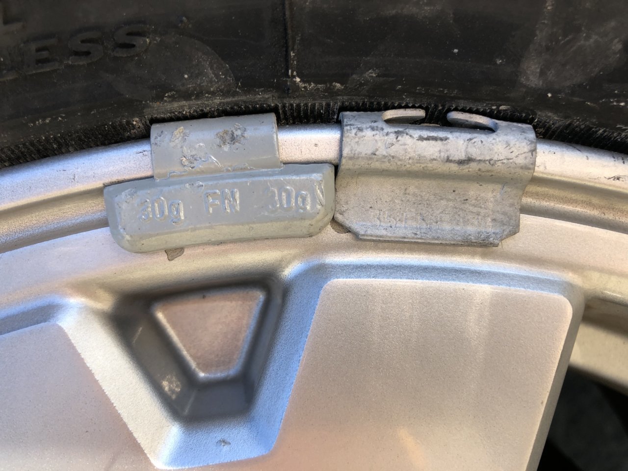

    Recently got new tires.
    While on the interstate something smacked the right rear quarter panel or fender well HARD.
    While inspecting the the tires/wheels I seen thing thing.
    Any idea what it is there for?
    It has some type of alphanumeric code on it?
    It’s the one on the RIGHT.

    it's a .25oz weight or 10g
    The other one is 30g or 1.25 oz and the FN is the style for the rim lip.
    You may have just kicked something up off the street or threw a weight off one of the other wheels.

    Yeah technically that one is probably an MC or one that would go for a different lip style the FN 10g weights are tiny.
