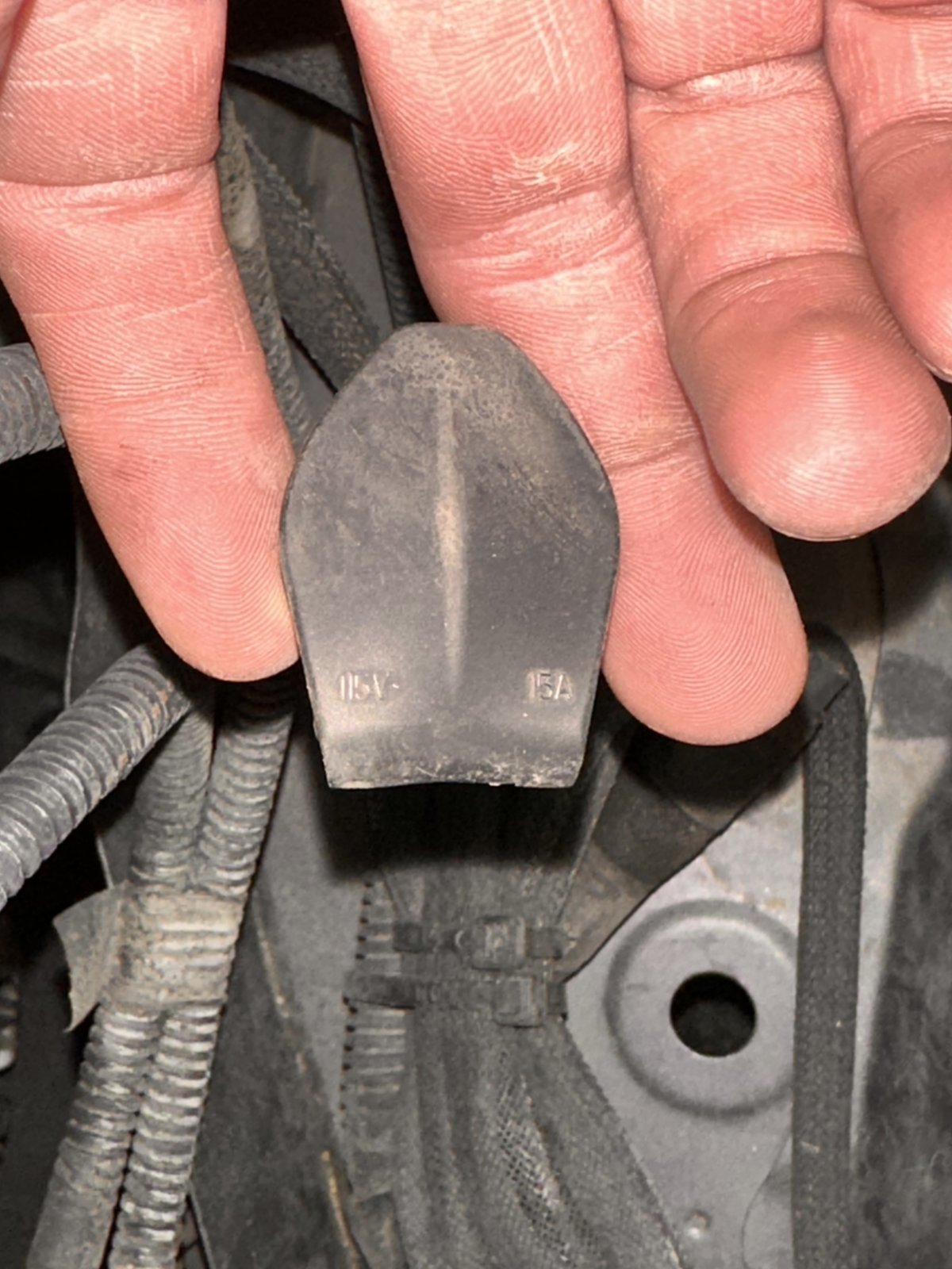

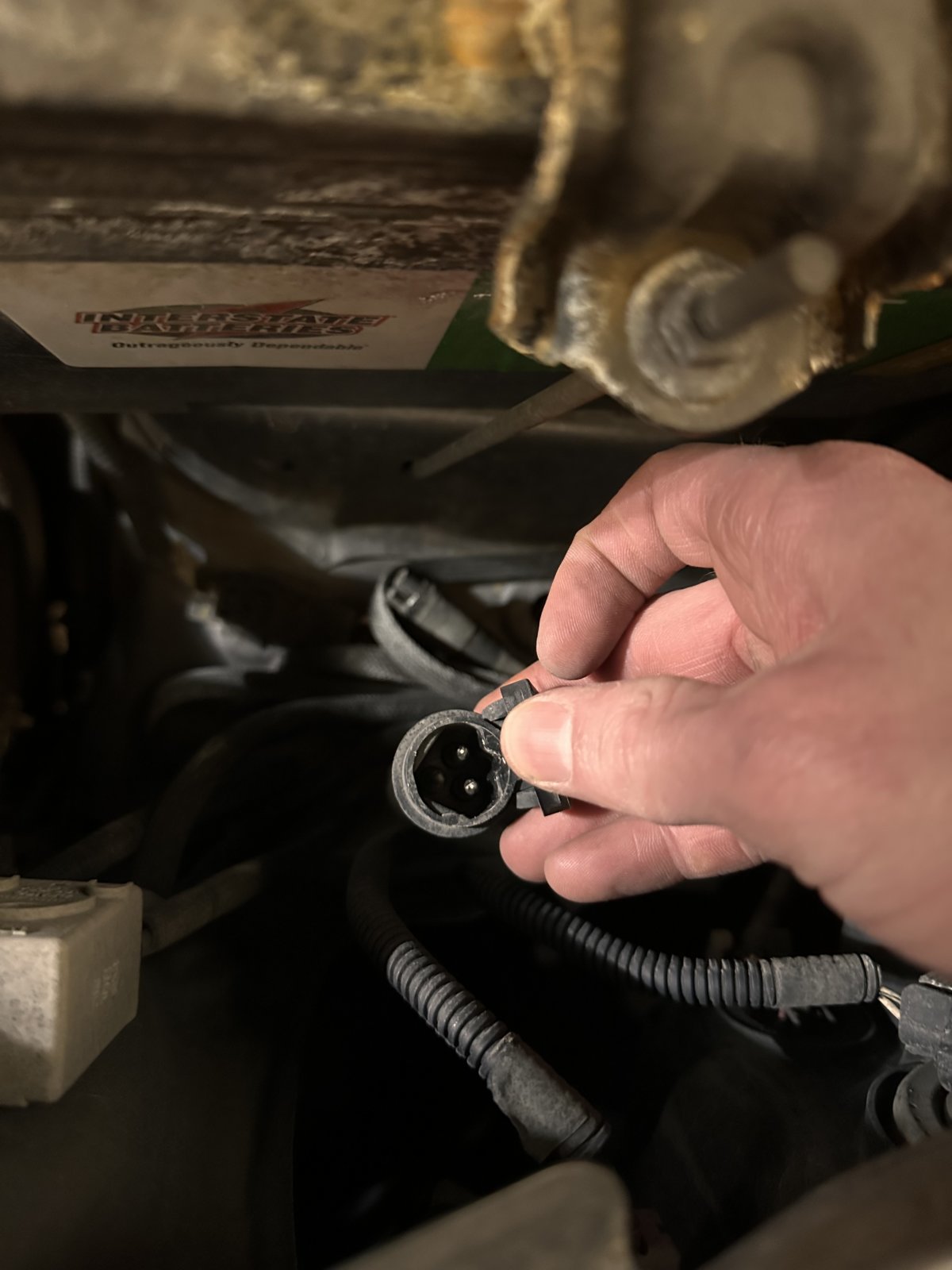

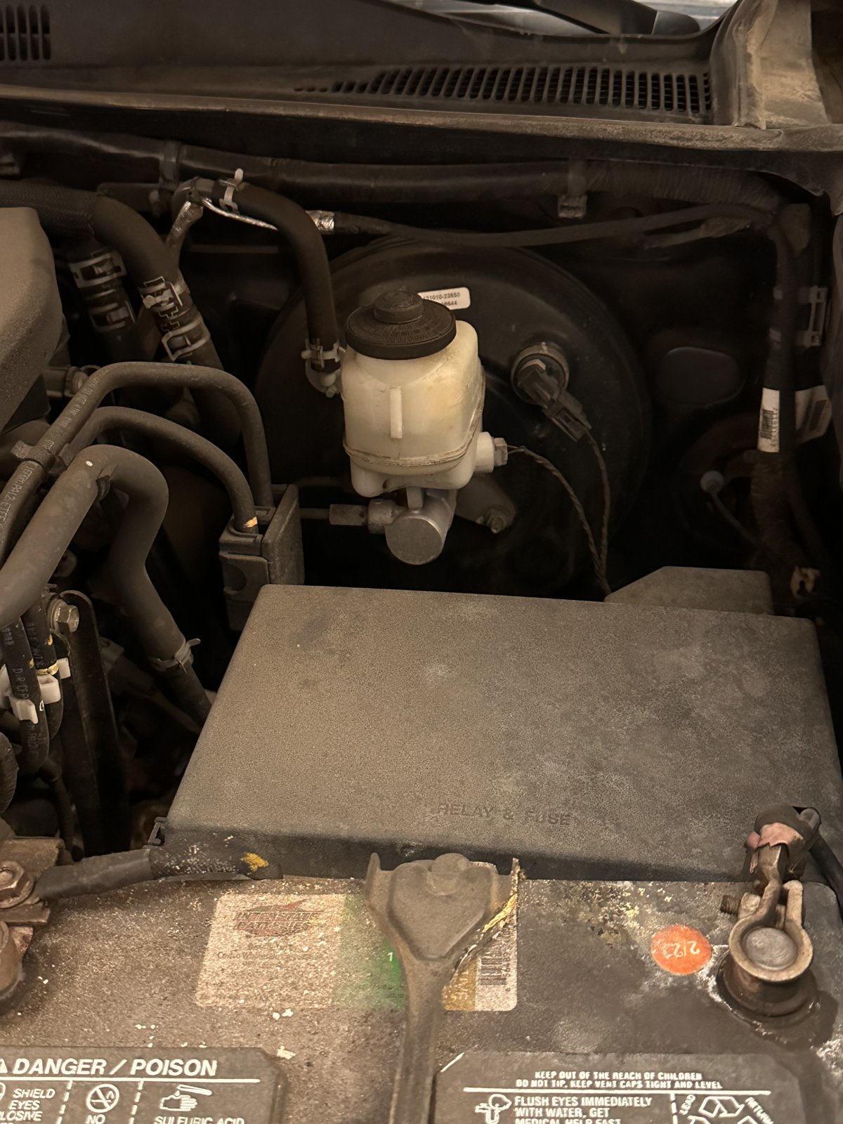

    Wondering if anyone knows what I might be able to use this plug for. I bought my 3rd gen used and just discovered it. The cord runs back behind the battery, around to the back of the dash, and through a point that’s hidden by the engine. I’m guessing it’s for a variety of after market mods? Any help is appreciated!

    Looks like a block heater pigtail

    That’s the premium block heater option. (At least here in Canada)It usually has a corresponding male cord with normal 3 prong 15a plug on the other end. Usually they drill a hole and mount little receptacle in the plastic bumper. I’ve used mine for years. It’s nice if you drive away and forget to unplug-it pops apart safely, and doesn't freeze up as bad. A nice, clean approach to a short cord dangling out and scratching everything up lol

    that's the factory-option electric block heater plug-in that's standard in cold weather states and much of canada.
    there was a significant recall on those. unless you can verify it was either updated or replaced with an alternate version, assume you have the version that can make your truck into a bonfire if plugged in.

    I’m in the US, but the truck came from Canada, so this is all making sense now! No plans to actually use an engine block heater, but that’s good to know about the recall. I should make sure it’s been fixed.

    The 115v is input...

    Another section of cord will plug into that receptacle you were asking about. That cord would plug into an extension cord, powering the block heater
