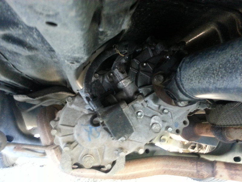

    this is on my 08 trd sport 4x4. i was under it greasing the zerks and saw this. not sure what it does. i have not had any issues. it is on the back of the transfer case. should i reconnect the wires?
    sorry i am not good with camera.

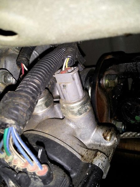

    new pic

    either speed sensor or transfercase shift sensor, and yes you should fix it.

    It looks like they go on that plug yea pretty sure it is a important wire.

    4wd position switch,fix it so your 4wd will work

    The truck wont go into 4lo. I took the connector apart and reattached the wires. Now just need to see if the yellow wire fits in the port more to the front or the back. Any help. I have called some friends to look at theirs and have not reached them yet.

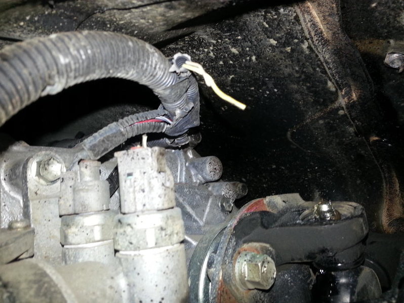

    Pic of mine, hope that helps.

    Thanks for the pic. I will put it together like that.
