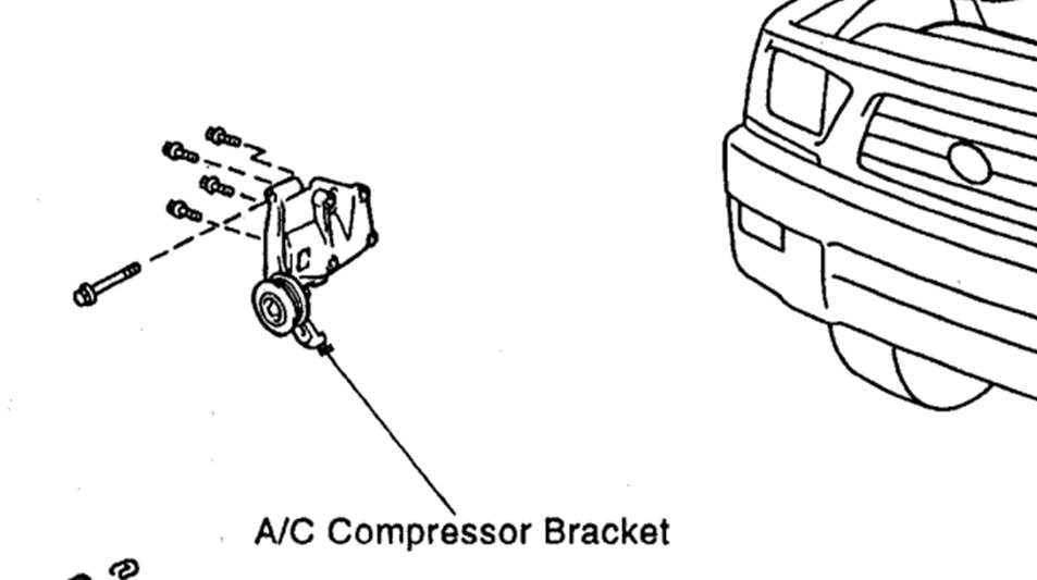

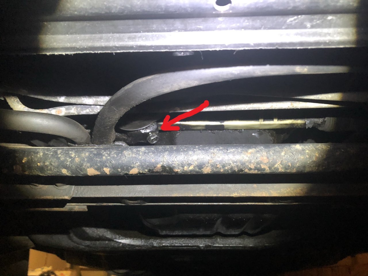

    View from the front of the truck. The bolt is on or right near what I think is the idle pulley, if the diagram is correct.
    I found a slow leak of what appears to be engine oil coming from this bolt, if it's a plug? It was only somewhat more than finger tight. I tightened it a bit.
    So partly I want to identify it so I can torque it to spec. And if that's not a plug, would something else close by or right above it be leaking?
    There's some residual oil from years of leaks I'm gradually degreasing away, but something around there was an active leak. I'll need to degrease and drive it again to check the leak status. The oil will be due for a change in the next few months.

    Looks like power steering or A/C compressor tensioner

    Yeah, looks like a tensioner bolt. so not a plug of any kind. You can kinda see oil above that bolt anyway. Bet it's coming from higher.

    Looks like belt tensioner bolt. The one where the arrow below is pointing. Stick your finger around the top/back side and up about 1/4" and see if you can feel the bolt threads after the bolt has passed through the bracket.
    If so, likely the oil is coming from somewhere higher up and running down.

    That was it, belt tensioner bolt! Should I loosen it back to where it was?
    After looking some more I think the leak is the oil pan nearby. I think the oil pan gasket is leaking in multiple places.
    The transmission pan is also leaking around part of the brim. 10 years ago a friend took off the transmission pan while replacing the trans fluid (I don't know why) and he didn't use the sealer stuff on the pan brim, said it was unnecessary. Maybe it's been slow leaking since then through a couple more fluid changes.
    I'm thinking I'll have the shop do the oil, trans fluid, and both pans in January when they reopen. The instructions make the pans seem like a lot of important steps that need to be done right, and if that trans pan is damaged from being smashed into place with no sealer then I don't want to deal with it myself.

    Tensioner should be snug enough not to fall out as the mounting bolts should have the torque to hold in place.
    Pan could be leaking, they are known to at this age. Wash under there well and determine before dropping off and it will be of benefit to both of you.

    FYI I think I determined the oil leak to be coming from the oil filter. Oil pan is fine. The filter untwisted too easily by hand, and the threading and whole area was pretty grimy. The plastic oil drain plug gasket fell apart in my fingers. New aluminum gasket.
    Transmission pan is still leaking enough near the stripped bolt to have fluid on the gasket edge but not enough to be dripping. Bolts I had tightened to 65 in-lb, and I tightened them further today to 70 in-lb.
