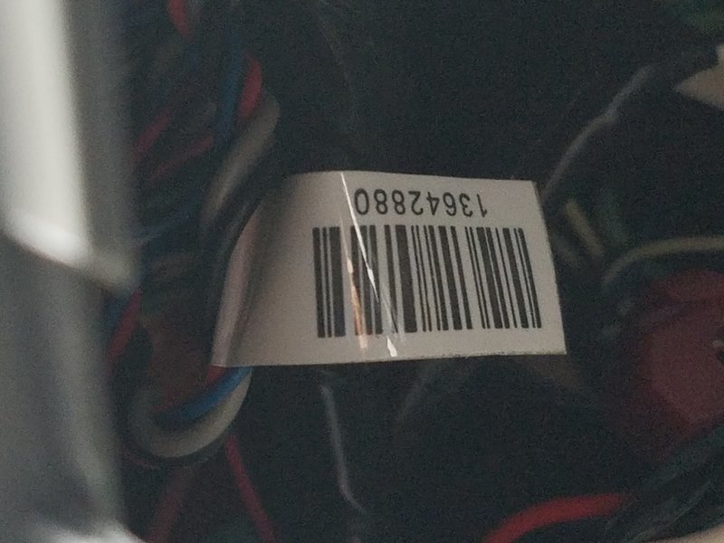

  12. Jun 14, 2017 at 12:09 PM
    #32
    gumby002
    gumby002 [OP] Member
    Jun 14, 2017
    #221480
    13
    2013 Tacoma - Black
    none...so far
    I'll check this evening and let y'all know.

  15. Jun 14, 2017 at 1:44 PM
    #35
    gumby002
    Jun 14, 2017
    #221480
    13
    2013 Tacoma - Black
    none...so far
    Audiovox Pursuit Prestige 13642880 Push Button Valet Switch & LED Combo PRLED
    Not sure what to do with it since I received 1 key and 1 toyota keyfob.
    Jack0928 likes this.

  17. Jun 14, 2017 at 2:07 PM
    #37
    climbhigher23
    climbhigher23 Well-Known Member
    Aug 13, 2016
    #194485
    604
    SoCal
    2017 QS TRD Off-Road 4x4
    2.5" King w/Adj 285/70/17 Wildpeaks Ray 10's
    I see those all the time. Gems they are. I would pull it out. Most likely just T-tapped in. You will need to cut out the starter kill and throw a butt connector in to reconnect it. Then just leave the LED in the dash to fill the hole.

  18. Jun 14, 2017 at 2:15 PM
    #38
    mynewtoy
    mynewtoy I like men
    Apr 16, 2011
    #55023
    2,559
    greg
    Mississippi
    09 double cab 4x4
    Detriot locker rear ARB air locker front 4.56 gears OME 3" lift, SPC uca's , moto metal 951 wheels 315/75/r16 Treadwright guard dogs, homemade front plate bumper with smittybilt 9.5k winch, homemade skids, homemade Bed bars, Mobtown offroad high clearance rear bumper with tire carrier, Homemade rock sliders , U-bolt flip, Wheeler's super bumps, BORA 1" wheel spacers , Black headlight mod , black tail lights, Satoshi Grill , autoPage C3 RS-665 alarm with remote start, flowmaster 40 series exhaust, cruise control,bed/ground effect lights, wet okole seat covers, tinted,windows, weather tech floor mats, AVS vent shades, debadged, hidden cobra 19 cb, 7" offroad lights behind grill, rear diff breather relocate, abs kill switch
    dude that's a win. you got a remote start all you have to do is get the fob
  19. Jun 14, 2017 at 2:17 PM
    #39
    mynewtoy
    mynewtoy I like men
    Apr 16, 2011
    #55023
    2,559
    greg
    Mississippi
    09 double cab 4x4
    that's the valet switch so you can turn the alarm/remote start off when you drop it off with the valet. so they don't get confused not knowing how to operate it
  20. Jun 14, 2017 at 2:22 PM
    #40
    mynewtoy
    mynewtoy I like men
    Apr 16, 2011
    #55023
    2,559
    greg
    Mississippi
    09 double cab 4x4
    keep tracing the wire down it should lead to a box. the box will have the numbers you need to order the fob. if you hold the button down for 5 to 8 seconds the led should stay lit. that's how you put it in valet mode
