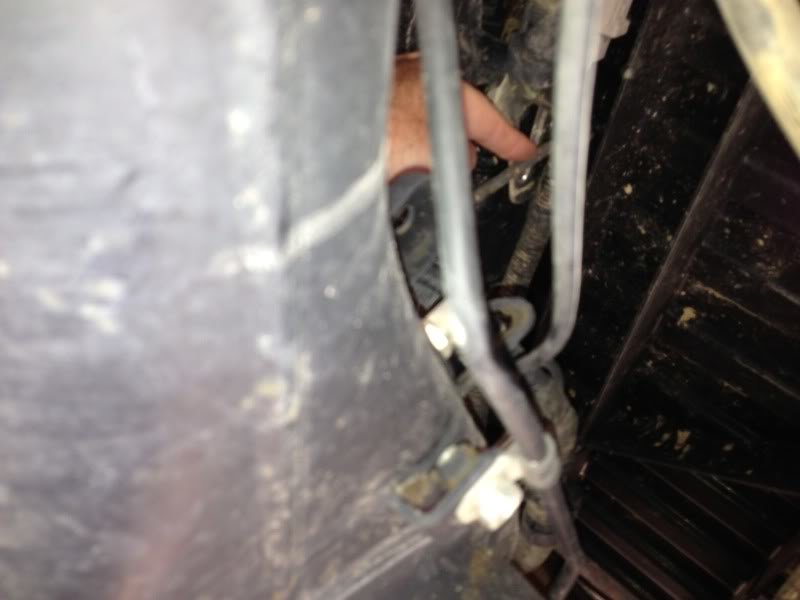

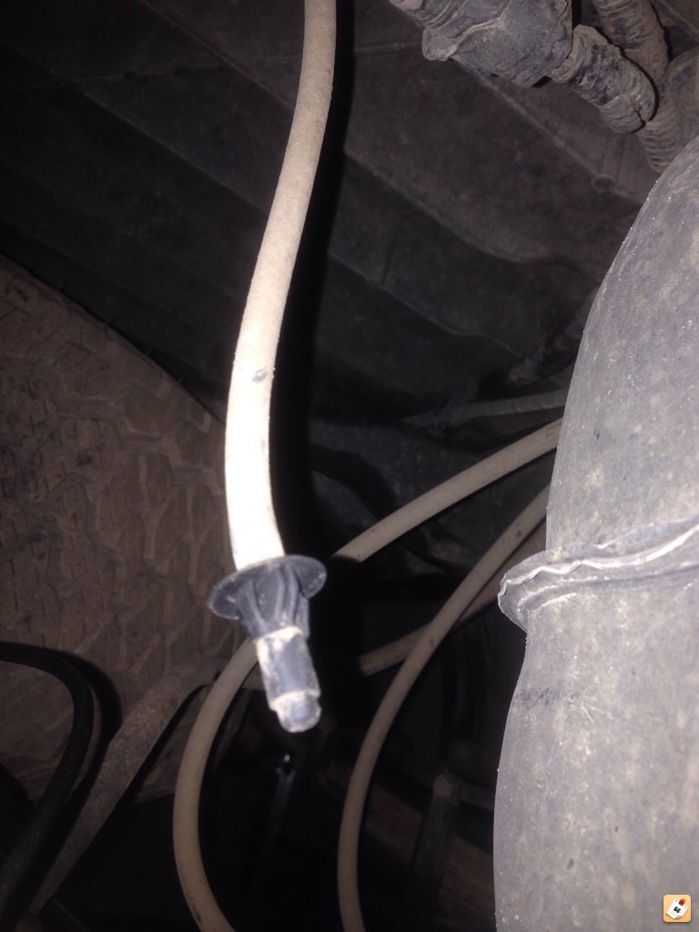

    I just saw this hanging down from a group of wires. Has a body clip type attachment at the end with a plastic tip covered by a rubber boot. Any ideas?ga5y7ate_08d098a67c5057ce2ff55884c9ecdc2e8a14a21b.jpgnyqe5ydy_50fc084e822e7096f1ae5fe4102645dfde3341c2.jpg

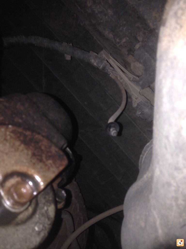

    The angles on your pics are throwing me off! Do you have an e-locker? That looks like it could be the factory breather for the actuator. If that's what it is, the plastic piece is supposed to be stuck in a frame crossmember under the bed. Looks like it pulled out of its factory location - lots of articulation?
    Give me a minute, I think I've got a pic of the factory set-up on my '12 before I did the breather mod.

    From memory, it is the e-locker actuator breather line. If you follow it back into the wiring harness it goes back to the actuator. The line is a smaller diameter harder material where it ties into the actuator. If its the blinker fluid line I'm screwed 'cause I tied it into a piece of 5/16 fuel line and vented it behind the rear taillight assembly along w/ the rear diff breather!
