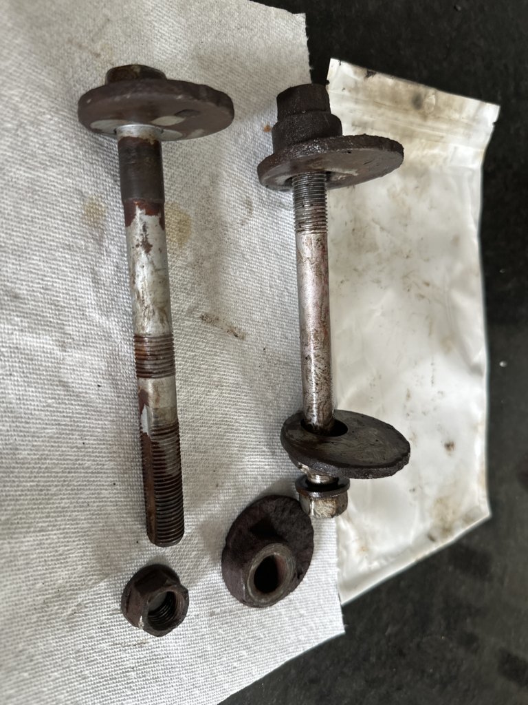

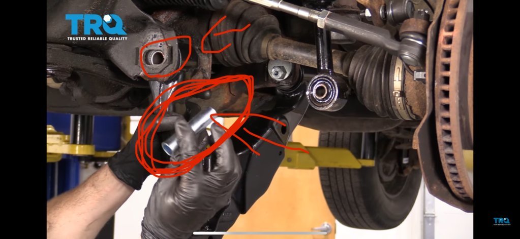

    I’m working on my Toyota Tacoma 2009 TRD but I’m a novice learning how to swap parts learning online but now I’m really stuck because I had to cut off this bolt as it seized from the Original OEM part
    I bought the
    Carquest Premium Suspension Control Arm and Ball Joint Assembly
    Part Number: #810-84779B
    But it doesn’t seem to come with that metal tube as seen in the video

    Bushing sleeve, inner sleeve bushing, ect.

    I believe the sleeve in the video is part of the aftermarket cams/bolts they are using. OEM hardware does not use this sleeve. Are you using aftermarket hardware?

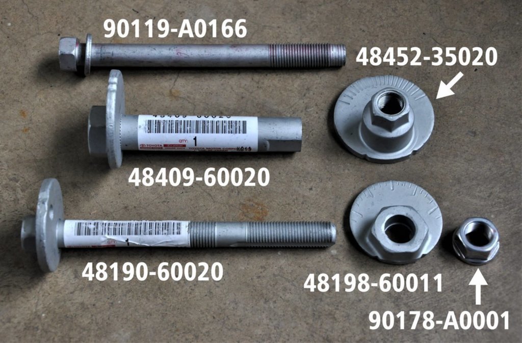

    OK I see what you’re working with now. There is a “sleeve” component to the OEMs, but it has one of the adjustment cams attached to it. When I had to cut mine out, I was able to salvage what you pictured above, and just buy the 2 parts from Toyota dealer. I’ll see if I can find a pic of what I mean.

    What you bought was a control arm assembly, what you need in addition are cam bolt assemblies per TacoJoes picture above. OEM is stupid expensive. There are other alternatives , greasable etc with mixed reviews. Last time I did this I went with these off Amazon. Quality seems good - these are super simple mechanical parts. No issues to date. Be sure to use some antiseize between the cam and bushing sleeves.
    https://www.amazon.com/48409-60020-48190-60020-2003-2009-2007-2010-Adjustment/dp/B0DKN78PNR?
    Look at the LCAs you are replacing and I bet you see the sleeve you are looking for seized in the old LCA bushing sleeve. You basically cut the cam part off the old cam/sleeve assembly when you cut them out.
    Note that the sleeved cam only applies to the forward LCA attachment point.

    If your control arms used the the sleeve pictured in the OPs linked video, the hardware was 100% not OEM. The OEM “sleeve” has an an adjustment cam on one end as I reference in post #8. You can verify in the picture in post #9. Part # 48409-60020
    The “sleeve” in the OPs video is NOT OEM
