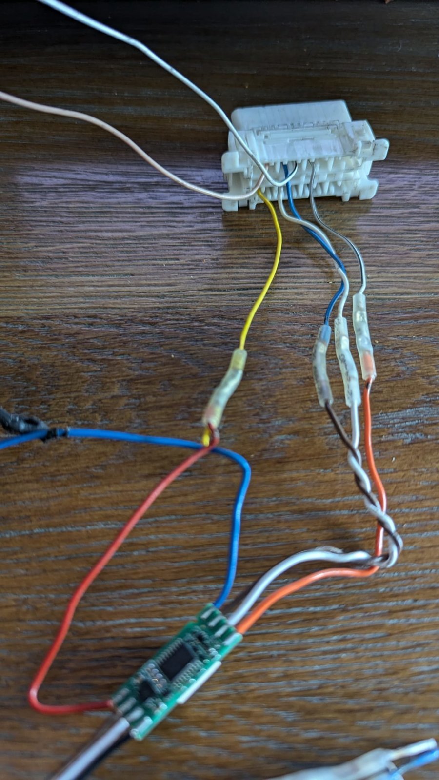

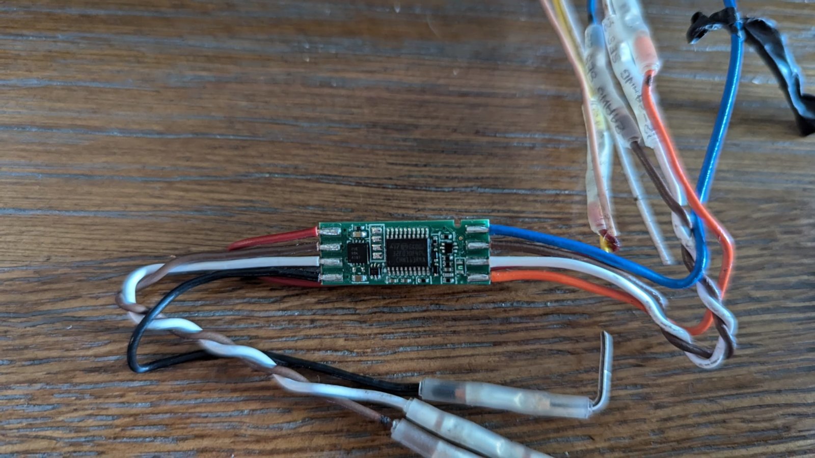

    I was wondering if anyone knew what this chip does?
    It was hardwired to my OBDII port, and I only found it because the dealer was unable to diagnose a CEL code. When they plugged in the scanner into the OBDII Port, there was power to the scanner, but no data connection. They did a bit more digging and found this chip piggy backed to the port.
    The markings on one side is B3SA012Z and on the other side GK002 32F030FP6 CHN113RNA

    It would help if we knew what wires it was tapped in to.

    Right, that definitely would help! My bad - Updated original post to include the wires that are going into the back of the OBDII Port.

    what does the blue wire go to? the gas pedal?
    i can tell you there's no antenna on that side, so it wasn't the TRACKING DEVICE that everyone might think it normally is.

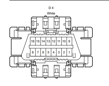

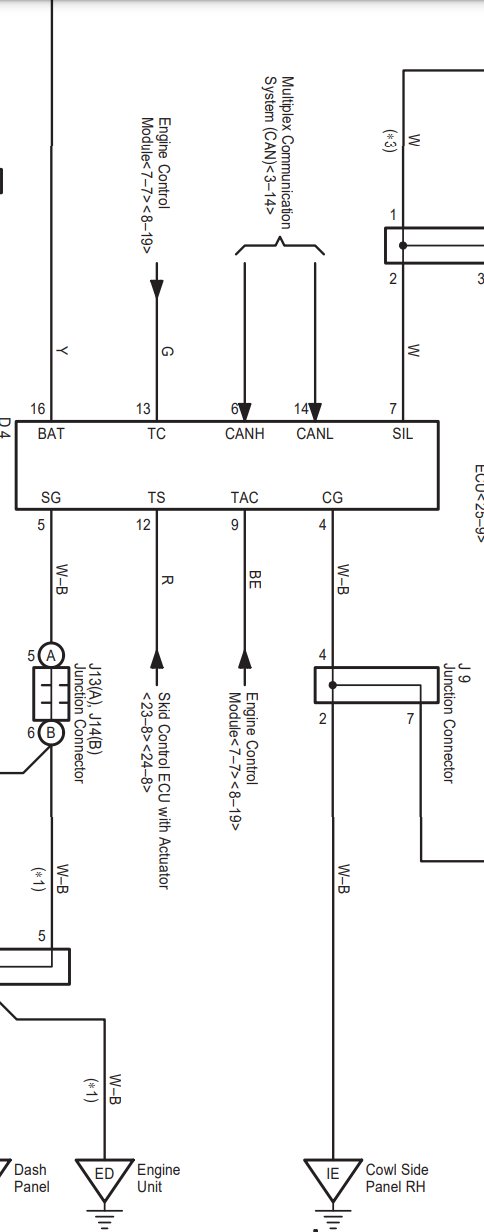

    It's tied into the CAN wires (Pin 6 & 14), Power (Pin 16), and Chassis Ground (Pin 4).
    Who knows what it was for but it's not a good idea to tap stuff into the CAN Bus on a modern vehicle.

    Are there any numbers printed on the board itself that might give a clue?
    The 1 chip number comes up as a prgrammable ARM processor so it could be used for literally anything.

    clear closeups of both sides of the circuit board would help a lot in identifying it further.
    but i still suspect it's some sort of discount pedal commander off a questionable site from a questionable seller.

    Wow. That is definitely a microprocessor & low voltage signal relay. Pedal commander? Some sort of tune? Alarm?
    Whatever it was --> GOOD RIDDANCE. That was a good catch by your dealer tech.

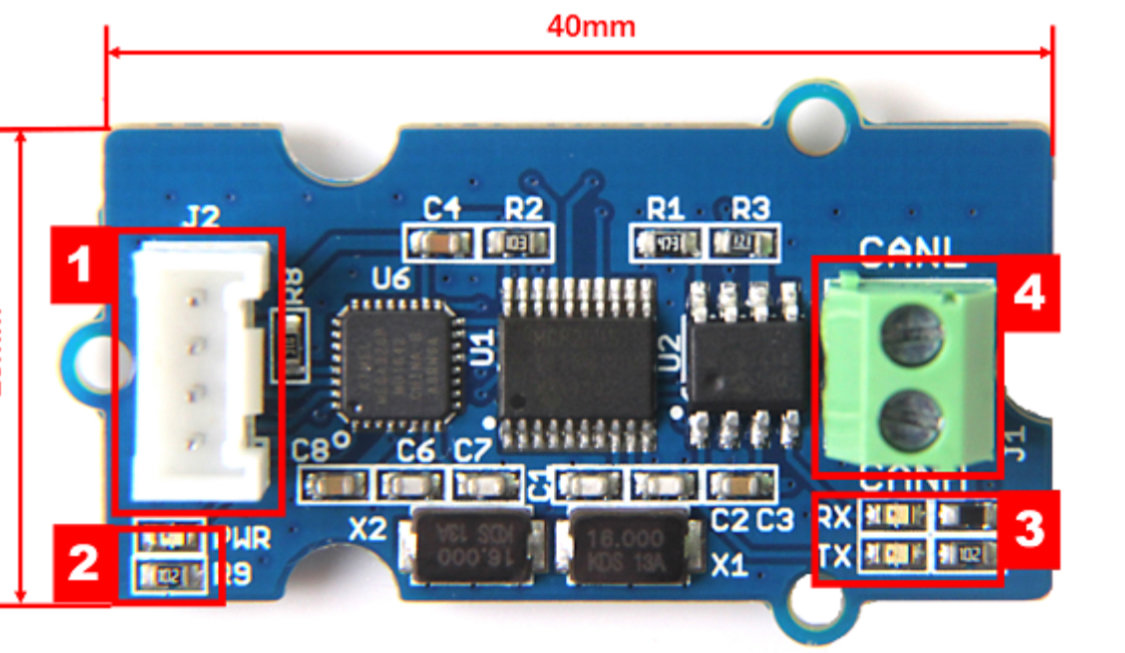

    Looks like a CAN to serial converter. Below is an image of a CAN to UART device, which is similar. The largest chip interfaces the CAN data stream, smaller chip handles the converted protocol, and looks like a couple voltage regulators or similar. It's a protocol converter for something else to read directly.
