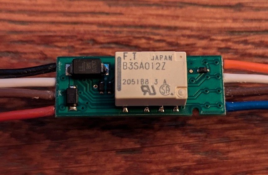

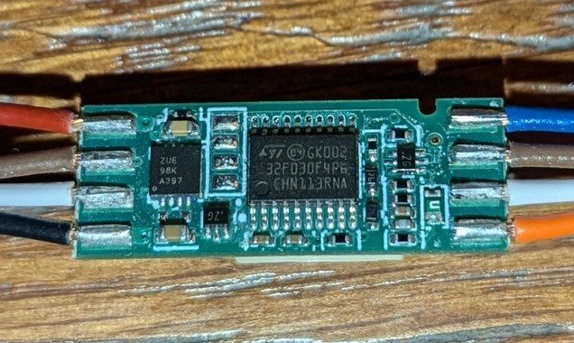

    Thanks everyone for the help and insight. Below are close up pictures of the chip/circuit board

    It looks home-made. The big chip is a 32-bit ARM cpu, and the ZUE chip I can't find any info on. It may be some type of amp or timer, as it has 8 pins. On back, you have a DPDT relay, a zener diode, a voltage regulator, and the larger black thing is either a Schottky diode or a decoupling capacitor....I can't read the numbers. The relay seems to be switching a 12 volt load, although it's hard to tell. The other stuff on back is just power regulating stuff. My guess is that this thing was monitoring the CAN bus, and switching on or off one or two circuits to something.

    Just a thought, but could this be from a very crude "heads up display" from alibaba?

    any typical option seems weird to me, as all of the normal modifications would have a plug, and not be hardwired into the obd port.
    my next thought seeing the relay on the back was going to be a nitrous system trigger(watch for full rpm, open valve)
    the only real way to know would be to dump the contents of the cpu...
    but i also don't think it's a homemade, or one-off board. given the green solder mask and the single-sided screen printing, it had to go through a board house-- while i know it's possible to do at home, the processes aren't worthwhile for a singular project of that size. the screen printing to me looks like one of the many budget chinese board shops-- it offers enough detail for crude placement reminders, but lacks the upgraded expense of clear and separate identification of each component location.

    I don't think so. There is no provision for a display output. There are 4 inputs wires and 4 output wires, which seem to be all from the relay. It was switching something based on data gleaned from the CAN bus is my guess.
