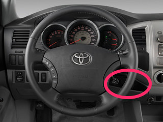

    Okay, so I tried searching the forum, but I can't find anything on this. What exactly is this compartment called? And how can I remove/tighten it?

    That's the garage door opener container

    I keep on bumping my leg into it (6'2") and it's gotten a little loose over the years. I keep my opener in it as well!

    I just want to know how to tighten it :rofl:

    I don't think you can. It just pops in on some tabs. Pull it out and see.

    Doesn't it just pull out? I didn't think it was secured with any screws or anything.

    It clicks in with tabs, if you pull outward with a little force it will come out, no screws holding it in.

    It's where the handle goes on the pull brake style models.

    yep, just pops in and out...probably only able to "tighten" it by removing and putting some double sided tape behind it and replacing it...I use it for dip cans

    Ohhh okay, I was trying that. I wasn't sure how it was secured, so I didn't want to break it.

    I figured out how to remove it while I was under the dash running wires...
    remove kick panel, remove 2 10mm bolts pull down on dash trim and you can better see where it clips in

    So I can't just pull backwards and it'll come out?
