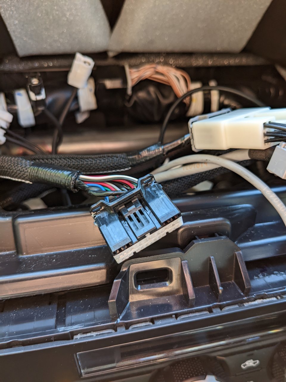

    Replaced the non-JBL head unit today to get all that new tech and there's a connector that doesn't seem to go anywhere. Does anyone know what this is? Seems to work without it.

    Yep first owner. On the back of the factory unit there are 3 jacks of 24 pins each in a row and this connects in the one closest to the driver side.

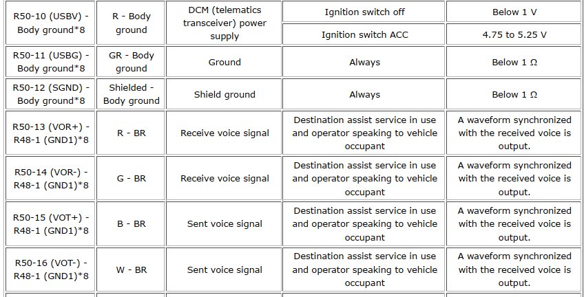

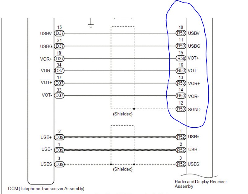

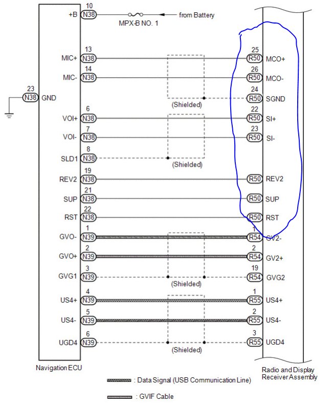

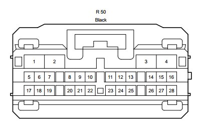

    It seems to be connector R50 that goes between the head unit, the telematics unit, and the navigation ECU. My guess is your head unit doesn't have factory navigation.
