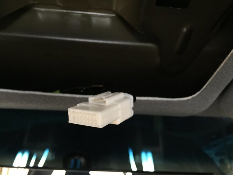

    What is this for? It was located above the headliner next to the mirror. I noticed it when I took out the map light assembely

    Temp / compass? I can't tell where it is exactly from the pic. Also a bluetooth mic might go there.

    The connector is for a "Home Link Mirror" or a mirror with out side temp and compass.

    This is right above the headliner at the front of the car right above the rear view mirror. When you remove the map light assembly (that is where the blue tooth mic is) you will see this connector just sitting there.

    It can not be ilused for temp mirro . Only autodim homlink one. There are only 3 wires iirc.

    Does the lead have 12V and ground? I need to hard wire my radar/laser detector and I presumed there would be a power lead there in my 2015 TRD DCSB, but it's nice to know for sure. It would be easy to replace the fitting to something I could readily mate to and that would sure be better than having to tie into the light leads.

    Yes, it can be used for a temp and compass. I bought a used mirror on this forum that toggles between temp and compass. Plugged right in and works just fine!

    This is where I bought the mirror. I wanted one that only shows the temp or with a push of a button, the direction because the digits for the temp display is the largest. My 2015 stock mirror had nothing. You just remove the overhead console, fish out the plug, plug it in and you are good to go.
    There is a setting on the compass to program what "zone" you are in for a more accurate reading. The one I have also has auto dimming. Bob has many types to choose from.

    I hard wired my radar detector from that wire, as well as an Homelink style auto dimming mirror. That was a plug and play application. Got this mirror because I would always have to squeeze my fat finger between my detector and the standard mirror. So I got one on fleabay for cheap. Now I don't worry about jacking with it when I'm driving.
