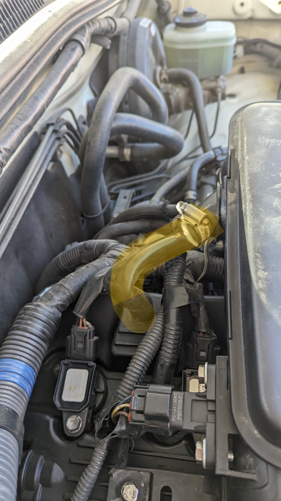

    My 2007 Tacoma 2.7l came with an after market intake which I have removed and replaced with a stock one. I'm missing the stock hose that goes from the valve cover to the larger nipple on the back side of the intake tube. The aftermarket hose is not fitting properly (hence the hose clamp) and I don't have the original. Anyone know the Toyota part number for this guy highlighted in yellow?
    Been searching parts diagrams all afternoon.

    I tried that actually....
    O'Reilly's and AutoZone didn't have anything.
    I got some dishwasher drain hose from Lowe's as the closest thing I could find and then realized the nipples this hose is connecting are different sizes!
    Plus the 90deg bend means a straight pipe folds and kinks closed.
    Annoying!

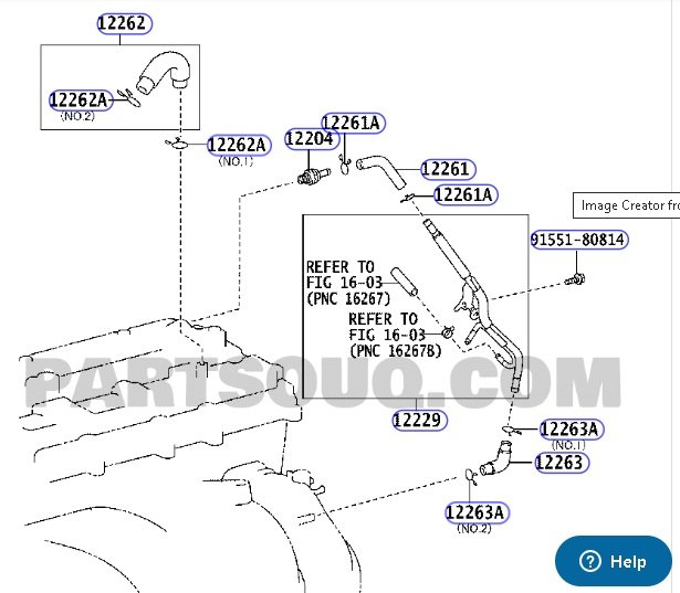

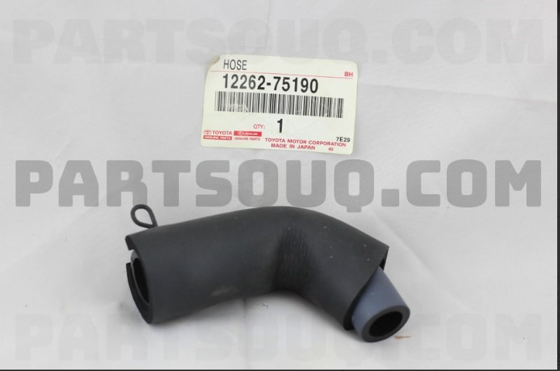

    This it?

    I saw that and think it is most likely the right candidate...
    I was uncertain because the diagram left me wondering where the other side terminated. Also the nipple on the valve cover seems to be in the wrong place. But on the positive side, there is a barb on the intake nipple, which points to the application of the included clamp.
    Thank you for this!
