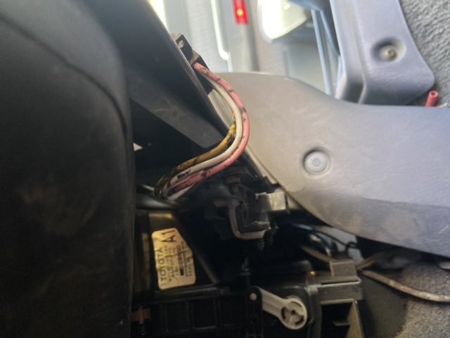

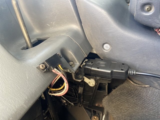

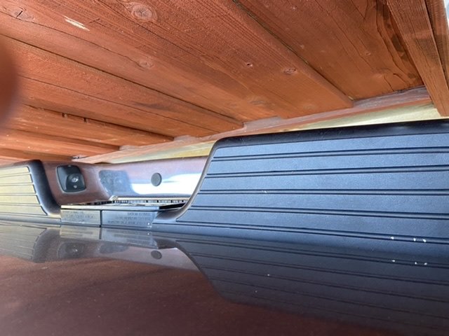

    I have this electrical connection on the lower front of the dash, but it’s NOT the OBD2 port. The IBD port is a few inches further back ( I have plugged my scanner into that to check and clear DTCs).

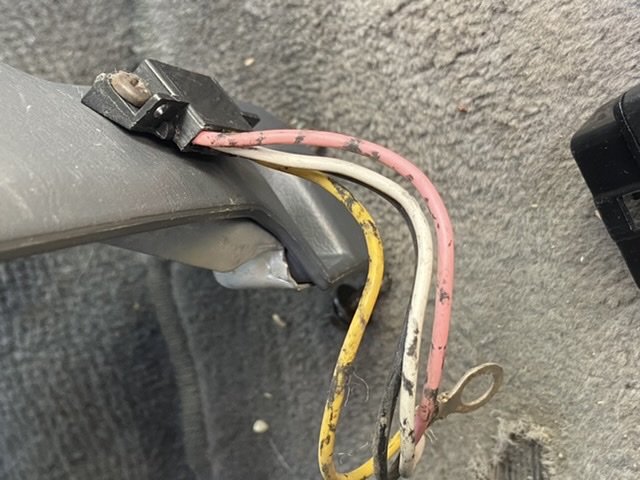

    when I was working on the clutch pedal I removed the lower dash panel, and all the wires for this other port were spliced together in a single ring terminal. It looks like a factory connection. all looks factory, the four wires ALL go to ground... the ring is attached to the lower dash panel mounting bolt right next to the port...
    My brother was the original owner, so it’s definitely Factory or pre-delivery dealer installed...

    My take it that it was a dealer pre-installed "immobiliser" that probably got "disabled" by a dealer because customer did not want to pay for it. For sure this is not a factory, witch this plastic thing screwed directly to the plastic lower dash panel with sheet metal screws. It looks better with this "magic connector" than if they removed it leaving ugly two holes in the lower dash panel.
    Very similar thing happened to my truck. When I was buying it from a dealer the truck had similar "immobiliser" installed in exactly the same place. Dealer asked 300 dollars for it, and I told them I am not going to pay a dime for the thing. They can give it to me for free or take it out. That "immobiliser" required some plastic "key" to be present in the slot for the truck to start. They did not give me the key, but they inserted a "master key" to the slot, so they did not give me the "immobiliser" for free, but at the same time they did not remove anything from the truck.
    I left this thing in place with the same thinking as above - the plug looks better than two ugly screw holes in the dash. And anybody who does not know it, thinks the truck has additional security system installed. Actually I know it's working as when I disconnected a ground wire from this plug the truck did not want to start.

    Four ground wires, and thats all its hooked up to?
    Somebody installed something, then for some weird reason grounded everything on the uninstall instead of just uninstalling the last remnant?

    Yeah, definitely not a brake controller. My brother never towed ( or planned on towing) anything...
    no hitch receiver and the factory plastic hole plug never removed from bumper...

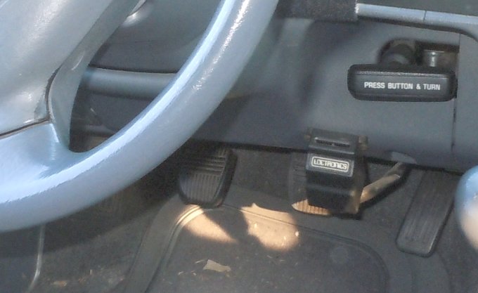

    I think it was probably a dealer upgrade “security” system that was never installed...
    I realized that there is this decal on the drivers door glass...

    My truck had something like this installed at the dealer before it was sold, it was called Locktronics. Simple engine immobilizer. It was removed years ago but the decal on the window and the screw holes still remain.

    This is exactly what I have.

    Yep! I had that. My truck was sold at Fremont Toyota, must’ve been a National dealer sorta deal.
