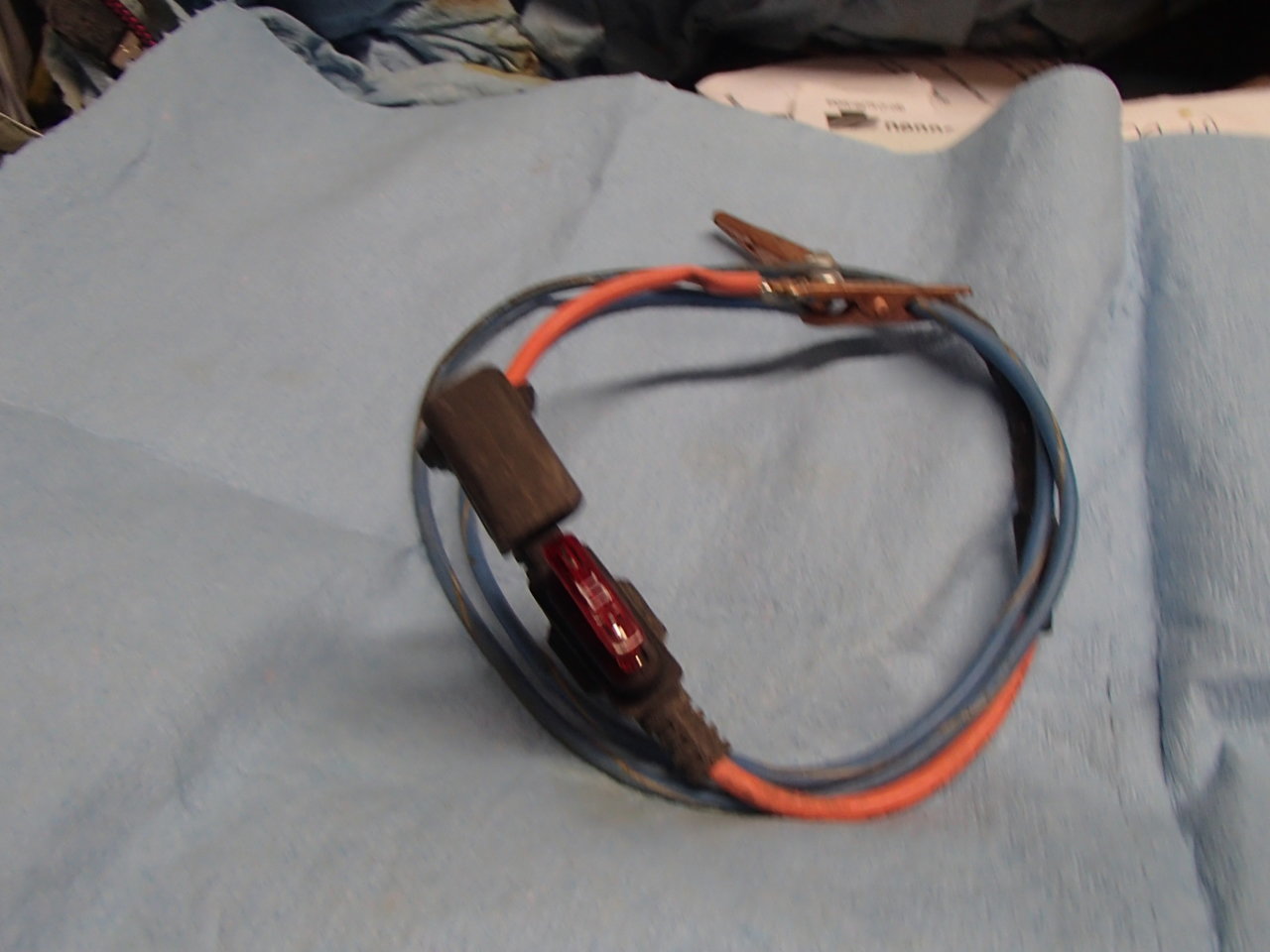

    Always fuse your test leads
    It can sometimes save your hands from being burned or a visit from the Fire Department and insurance adjuster.

    This is why I like using a multi meter in series while testing stuff. Cheaper to replace fuses than burn up some electronics.

    What does fusing a test lead mean?

    Adding a fuse in series with one of your leads.

    Still no idea what you're talking about. When you say fuse I think of the things in the fuse box that I have to replace if I one goes out.

    this a fused test lead this fused test lead 001.jpg has a 10 amp fuseorry it is a little blurry
