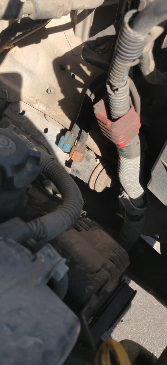

    Hello I am new to this site although I have been stocking the forums for a while now, I have a 99 SR5 it's a manual transmission and after finally fixing the dial for my heater I was so excited to use it again and the heater did not work I am looking at my engine at some other leak issues and stuff like that that need to be fixed and realize these two things hang in there not plugged in and color coded in a way that makes me wonder if it has anything to do with my subsequential problem, HELP.
    if you do know anything about either of the issues or have any comments that may help it would be much appreciated thank you.

    Do you have manual locking hubs or ADD? I have manual hubs and I noticed some plugs hanging exactly where you are showing. I traced them to be ADD wiring which is not used, because I do not have ADD.

    The harness are all the same so you will find a lot of thing that don't do anything.

    Gotcha I do in fact have locking hubs thank you for the info
