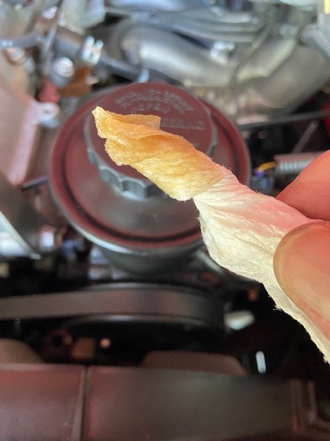

    I noticed what appeared to be a bit oil around and under the steering rack guide. Not enough to drip but enough I could see it looked more like oil than ATF. I checked the pump reservoir by dipping a paper towel in it and I don’t think this is ATF, at least none that I’ve ever seen. I think the P.O. may have had the power steering serviced and they used power steering fluid.
    Should I try to flush this stuff out and replace it with ATF?
    Is their way to seal the rack guide?

    Shops that seldom see Toyota vehicles Use Power Steering Fluid all to often.
    You can try flushing but the damage to the seals may already have happened.
    You can always rebuild the Steering rack The only thing that will fix leaky seals is replacing.
    You can always try a Hail Mary with some sort of power steering stop leak I have no experience using that.

    Says ATF right on the f*ing lid of the f*ing pump. I need to go through the receipts from the P.O. to see who was that stupid. Probably the same place that used permatex on the oil drain instead of a 15-cent crush washer.

    You could flush whatever's in your steering system out and replace it with ATF (which of course is factory-recommended). Here's what I would do:
    1. Buy a couple quarts of ATF and a turkey baster.
    2. With the engine off, use the turkey baster to suck out as much of the old fluid from the pump reservoir as you can.
    3. Refill the reservoir with ATF and reinstall its lid.
    4. Start the engine and move the steering wheel from one lock to the other 10 or so times.
    5. Repeat until the turkey baster appears to have all ATF in it. This will take several repetitions.
    Hope this helps!

    What I meant was it doesn’t matter if I’m leaking ATF or power steering fluid, the damage is done. I’ll do the flush this weekend but I don’t think it’s going to fix my problem, I’ll just leak ATF instead. Guess I could have worded that better. It just pisses me off that pump says ATF right on it and someone still used power steering fluid. Kinda pissed at myself for not catching it earlier, I’ve checked the level but never the color.
