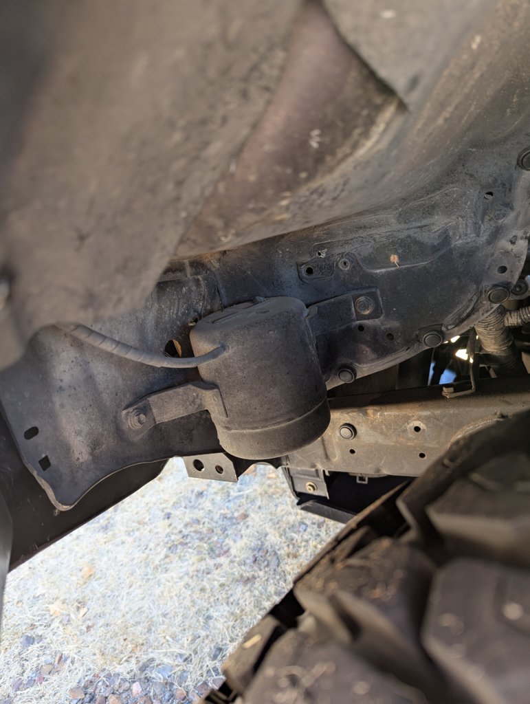

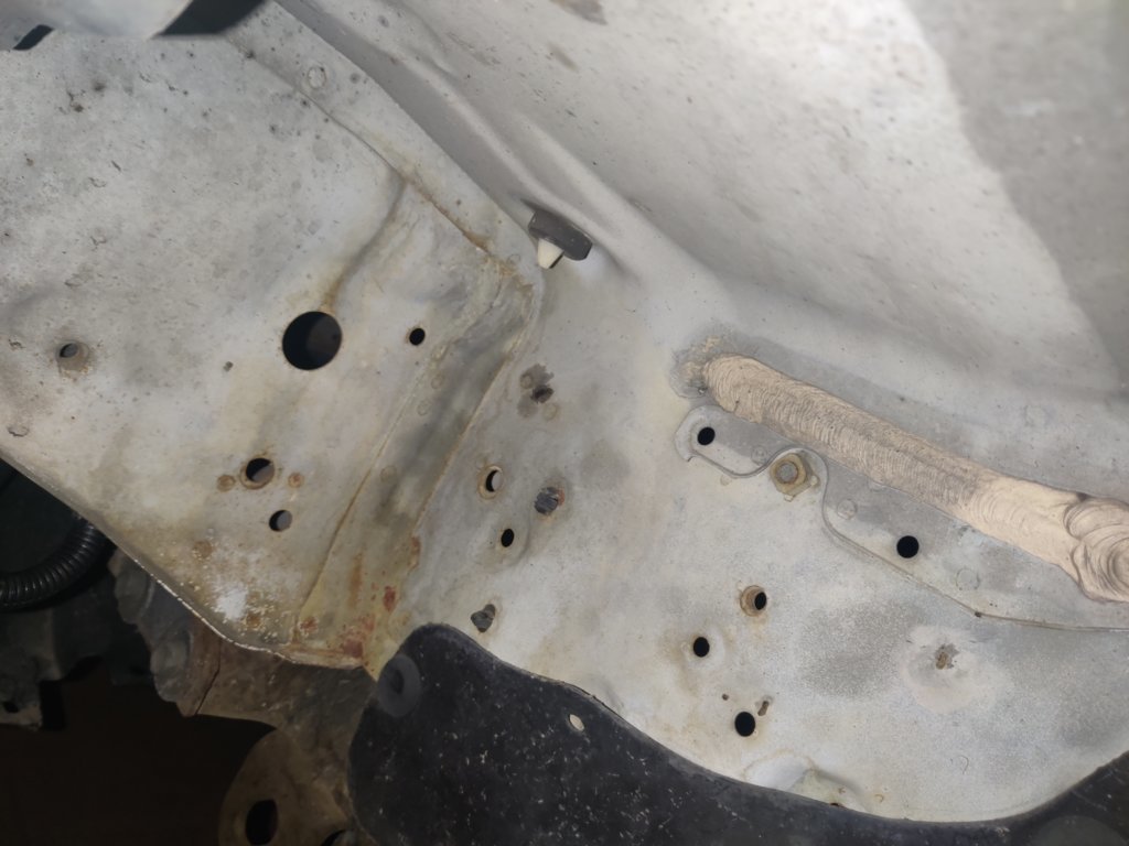

    For the life of me I can not figure out what this panel is called and what the part number is. Can anyone help me figure it out?
    it is missing on the drivers side and as you can see in the image below and I would like to replace it!
    Thanks in advance if anyone knows what this is!

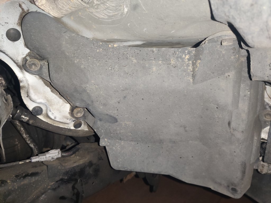

    Just to clarify what it is that I am trying to identify...

    So yeah, passenger side is the hard plastic cover for the washer reservoir.
    P/N 8533604010

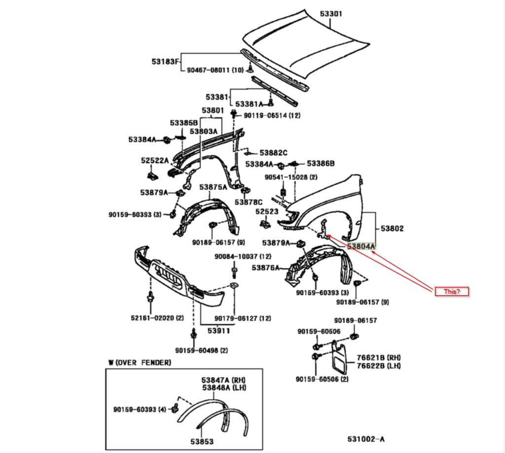

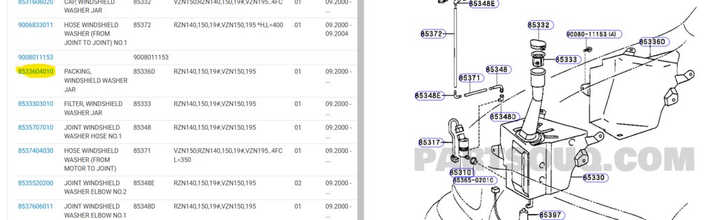

    Could it possibly be this? It is really difficult to tell from the diagram...
  8. Jan 15, 2025 at 8:14 AM
    THatt
    THatt Well-Known Member
    Aug 23, 2022
    #404202
    1,037
    Upstate SC
    1996 Tacoma 2.7L MT 4X4
    Don’t think there is one for the drivers side. Believe it’s because the battery mount occupies down into that space. I recall doing this searching myself since it looks like the piece is missing. Arrived that it simply doesn’t exist.

    Ya, I think I am coming to the same conclusion, but it looks odd, like something is missing, especially with all of the threaded bolt holes/mounting points, etc. My truck has not been in any reported accidents, and I know the previous and only prior owner well, who has no recollection of anything being removed.
    IDK, if anyone else has a relatively stock 01-04 4WD could you post a picture of the front area under the driver's side fender? That way I can close this mystery!

    Okay, not to belabor the point, but I looked under the fender of a friend's '98 (mine is an '03) and saw a coffee can-shaped object bolted there. It's probably some sort of vacuum canister. I'm not sure if it was omitted from later first gen models by design or intentionally removed by a mechanic. The only previous owner is a close friend, and I can say without a doubt he wouldn't have intentionally removed anything, but who's to say his mechanic wouldn't have?

    To follow up, it looks like in earlier gen 1 models there is a charcoal filter or vacuum reservoirs thig (looks like a tin can), but newer gen 1's don't have anything bolted in there. It just looks strange because all of the studs/mounting points in the panel were not removed and it looks completely different from the passenger side which houses the windshield cleaner reservoirs.

    Nothing belongs in that area of the driver side for 01-04. Case closed lol

    Where did they move the vacuum canister for later model gen 1s?
    Was the actuator turned into electronic actuator perhaps?
    I have the canister buried under there in my rig

    On my 98 I have that passenger panel, it protects the windsheild washer bottle and pump.
    On the drivers side is a metal vacuum can with a single vacuum hose attached to it that goes to the top of the intake plenum. There is no cover on the drivers side.

    This is exactly what I have observed, they just did something different for later models, but did not delete the mounting points!
