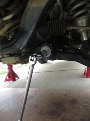

    anyone have any pics of what the LCA look like and what bolts to check?
  19. Jul 3, 2016 at 6:07 PM
    #59
    Sandman614
    Oct 26, 2010
    #45273
    35,580
    Tim
    Garner, NC/Boone, NC
    '06 SR5 Off Road
    You serious? *note: you tighten/loosen the front(bolt head) of the front bolt and the rear(nut) of the rear bolt.
