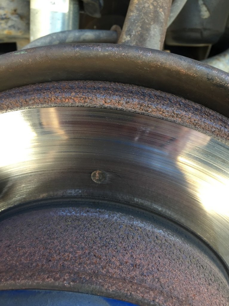

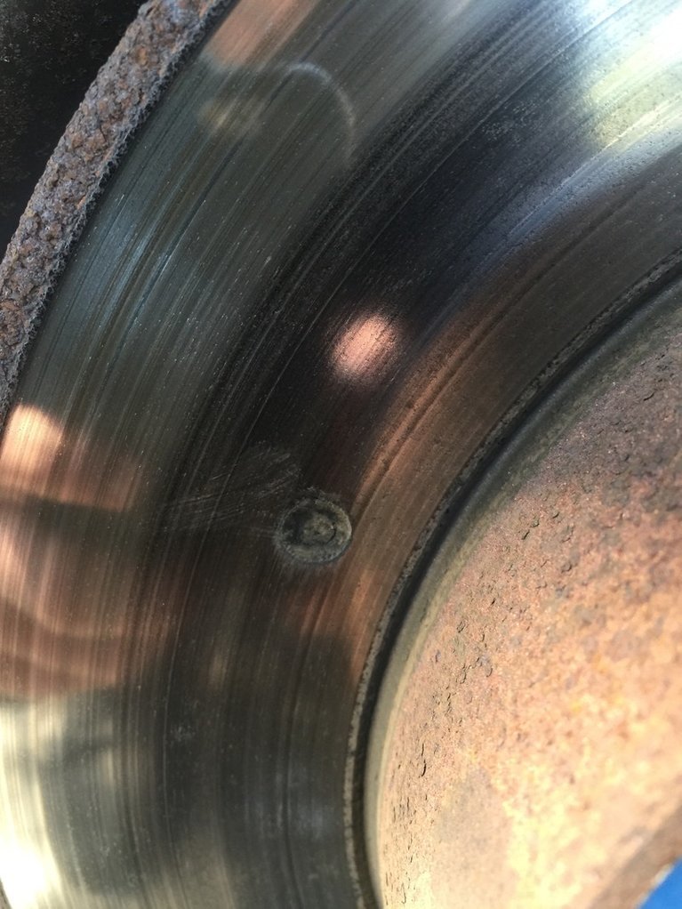

    I don't think I need to change my rotors, but there's a little circular indent on them... What is it?? The rotors feel fine and look like they have plenty of meat left...
    B8153277-5289-4EDB-B4FE-DA56327215CC_zps_6418994648be31e990d3b86b2845d178d4ac3ce6.jpg

    Pretty sure its a wear indicator, ive seen them on some textar rotors

    yep, no harm, no foul
    is a little odd thou, I never saw them before

    k. Seems like its a wear indicator. I just pad slapped her and called it good :)

    It's a wear indicator. I would replace them. When you see that it's saying its past the minimum thickness.
