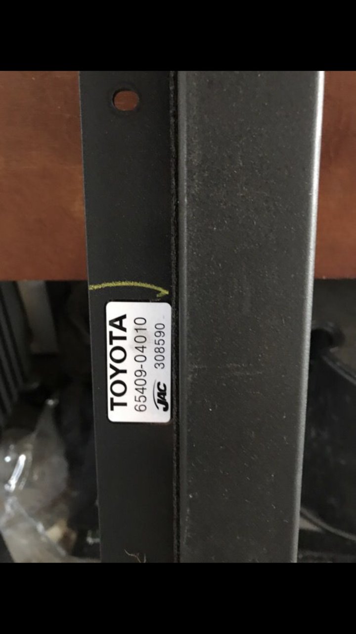

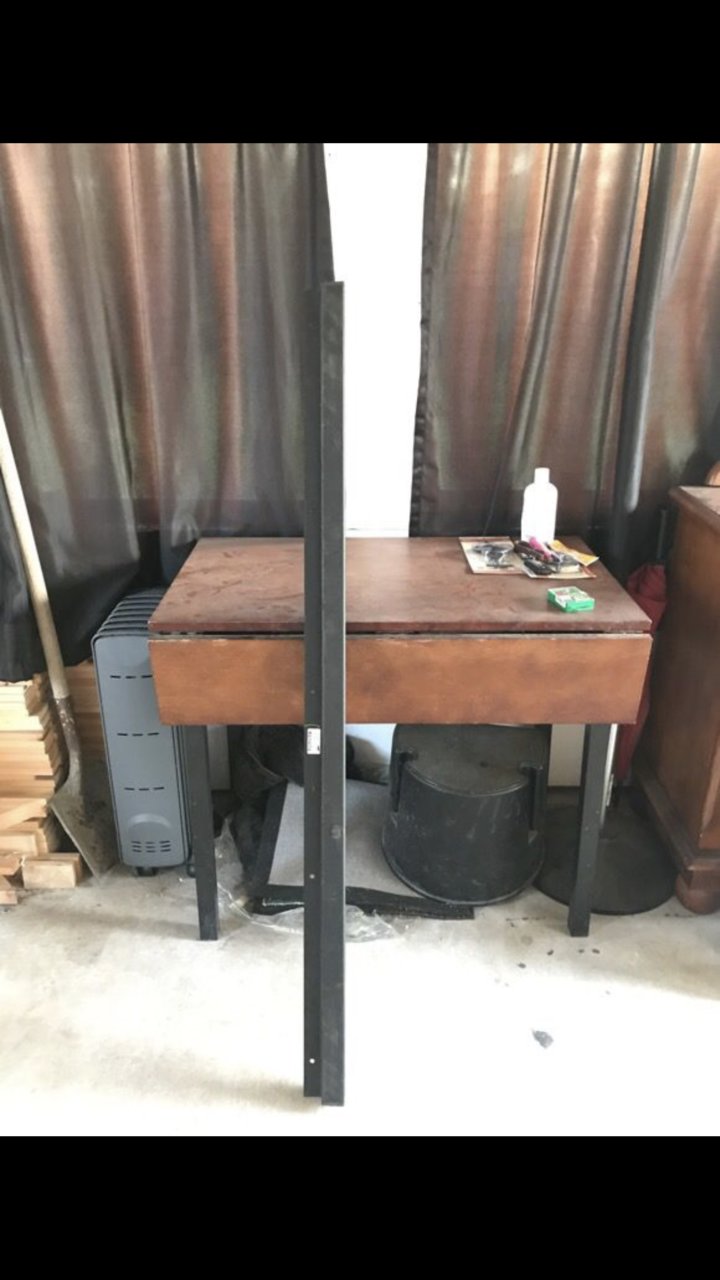

    Yes I sold it but here are some photos

    6BCB8746-C20B-44BC-9113-44C870C871E7.jpg Here is the part that has paint scratched off in your picture. It’s (#2) on this diagram, but I’m not finding it for sale. I’d think someone has it for sale.
    It’s not the side rail for accessory attachment.
    You could use touch up paint, spray it or perhaps find a used one like has been suggested.
    I removed the one on my truck and ran silicone along its underneath and back side and plastic end caps in preparation for a canopy install. The canopy seller suggested it to seal water from leaking in from underneath this top of bed piece. He said that he had seen a little water come thru from under this part on Tacomas.

    There you go. Someone beat me to it.
