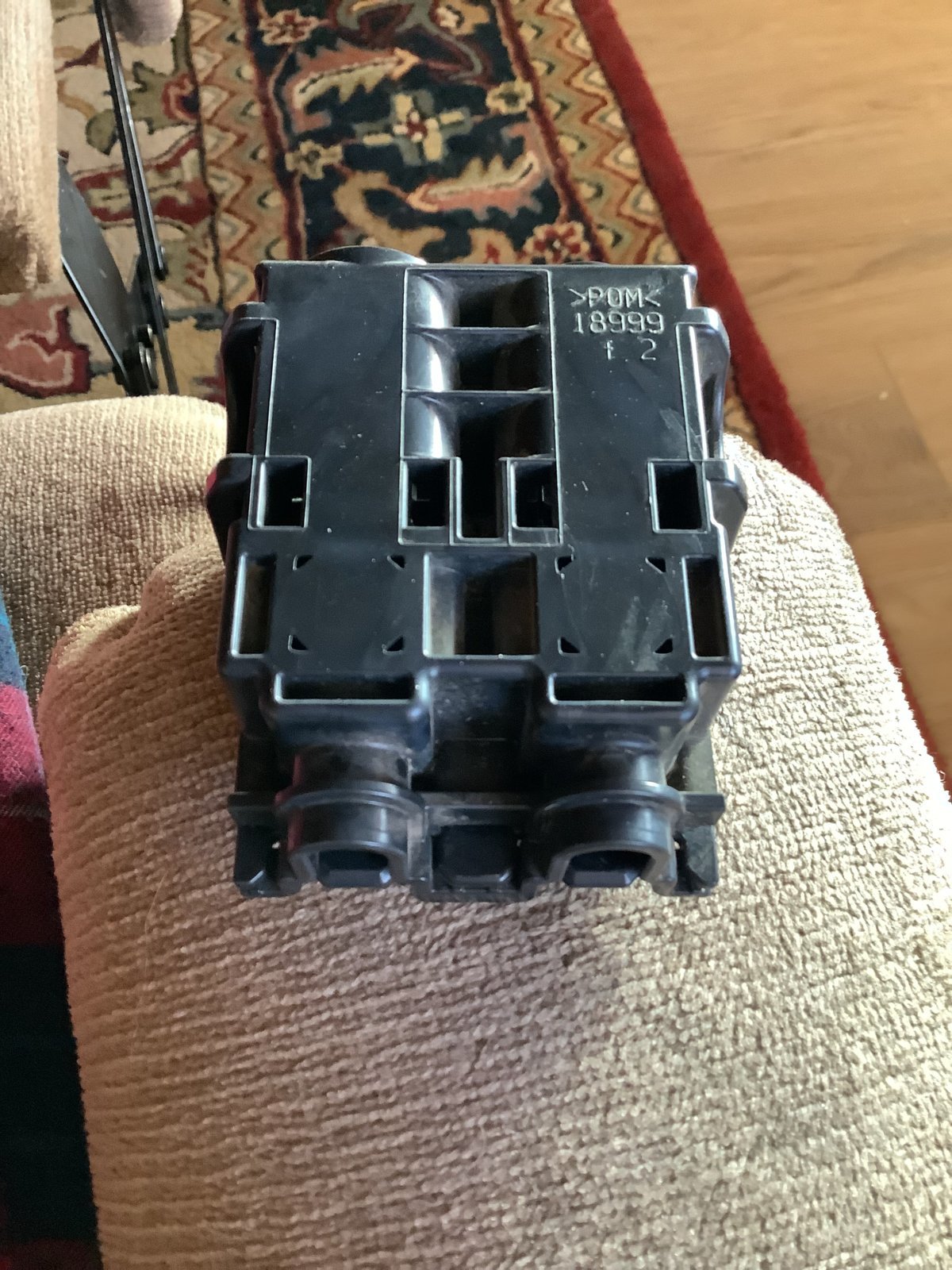

    Does anyone know where this goes! Left in engine compartment after maintenance on 2021 Tacoma V6 auto. IMG_0486.jpg IMG_0485.jpg IMG_0486.jpg

    fuel line safety thing. Drivers side near the firewall. Comes off during fuel system service.

    Thank you! That explains it…so obvious I missed it..going back on right now.

    Would let the service manager know on that one.

    Fortunate that you didn't lose it going down the road: It looks expensive.:spending:

    Yep..it’s back in place and the manager at the service department will here about it..it was left on top the vent just below the windshield tucked under the hood. Same place only tightened my drain plug hand tight..might be time to do more of my own work..geezee wheezes

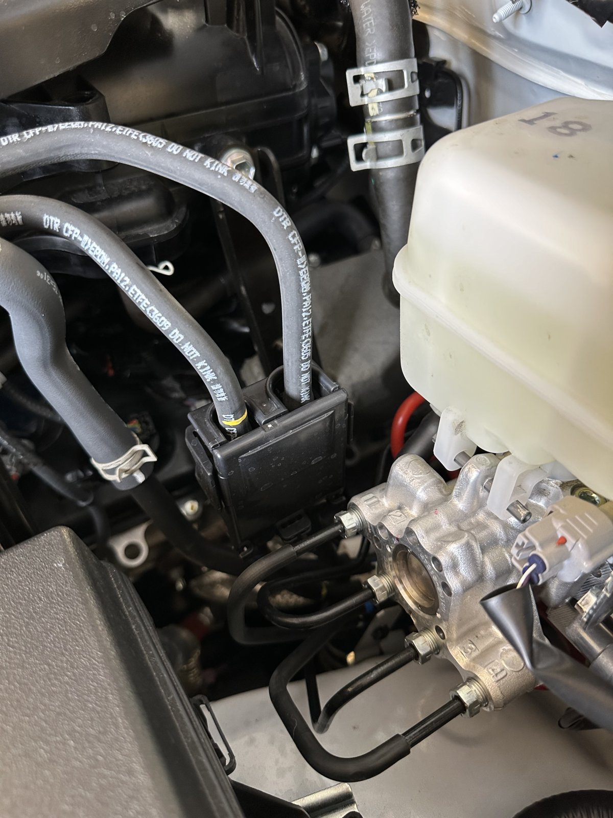

    so were those 2 hoses just dangling there? if so should have taken a pic and a pic of where the part was left.

    Are those the high-pressure DI/Direct Injection fuel lines?

    ^They would not be under high pressure. The high pressure lines are metal (similar to hard brake lines).

    That dealership is bad news. That is totally unacceptable, two issues

    Imagine that guy doing a timing cover reseal. Half the engine would be missing

    yep. the cover consists of 3 parts the 2nd goes over part of the 1st one then the 3rd one also goes over part of the 2nd and 1st one. some of the bolts on the 2nd and 3rd one go thru the 1st one to the block, making a timing chain cover sandwich. the process has to be done quickly before the sealant drys too much on the first and 2nd one.
