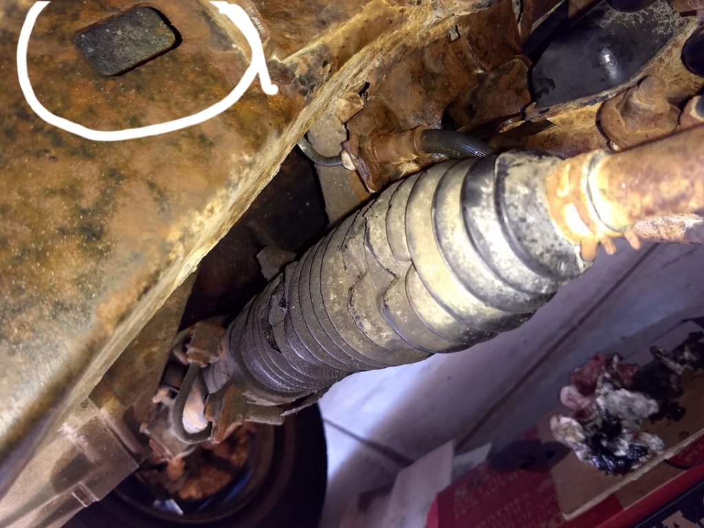

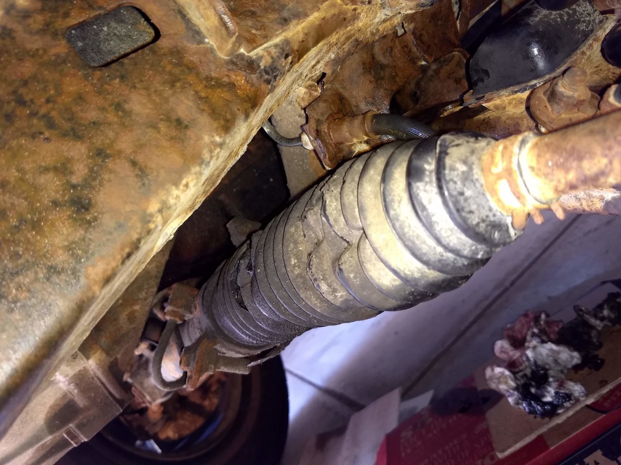

    This arm has a torn boot. This is a 5 lug RWD Taco. I looked at the online parts catalogs to ID this part and boot but could not find anything with a boot like this.
    What is this arm? How hard is the replacement of the boot?

    Looks like inner tie rod/boot.

    This is correct, may also be called a steering rack boot.

    Please; thoroughly inspect your truck and ensure you're not driving a death trap.
    That rust is scary looking :eek:

    You can see right here it's still black on the inside ... heeeeesssss ffffiiiiiinnnnneeee :D
    Kidding. Totally kidding, @Kwikvette is right... inspect your spring perches especially

    But yeah, that's the steering rack boot, and if the boot is torn, there's a fair likelihood that dirt and grit has been getting inside the steering rack, so that may need to be rebuilt/replaced.
    Also rust....
