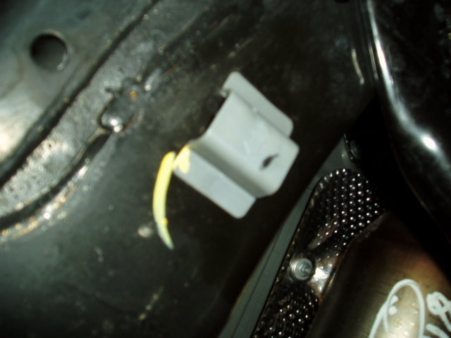

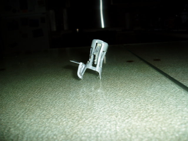

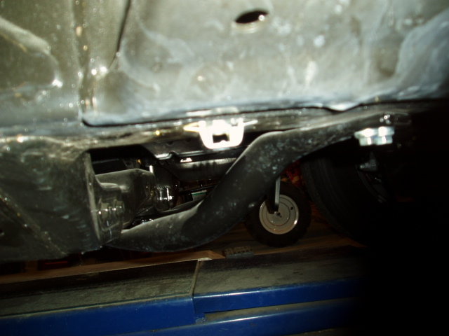

    Hi all,
    Vehicle is 2020 AC Sport MT. Part is plastic and in the bottom of the frame just ahead of the crossmember to the rear of the front wheels. It is plastic and fits in a square hole. Has an arrow pointing forward. The goons doing an inspection put the lift arm on it and broke it. What is it and what does it do? Drain maybe??? Sorry for the lousy pictures.
    Thanks.

    Looks like some type of electrical plugin??

    It allows water out but stops dirt from entering.

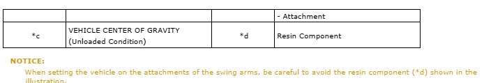

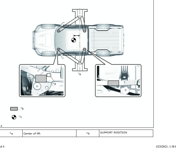

    The FSM even specifically says to avoid these when lifting the vehicle (referred to as a 'resin component').

    New truck here, mine is also smashed.

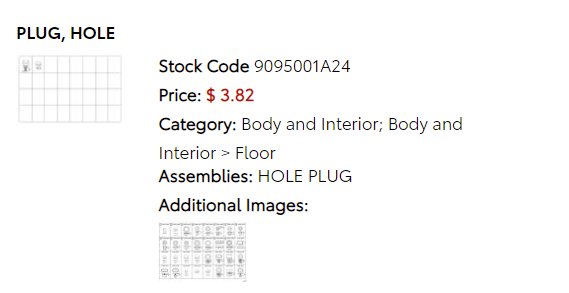

    I just ordered a couple plugs from a local dealer. Cost was $3.82 ea.+ tax.
    Part number in post # 3 worked...
