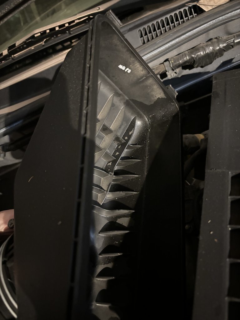

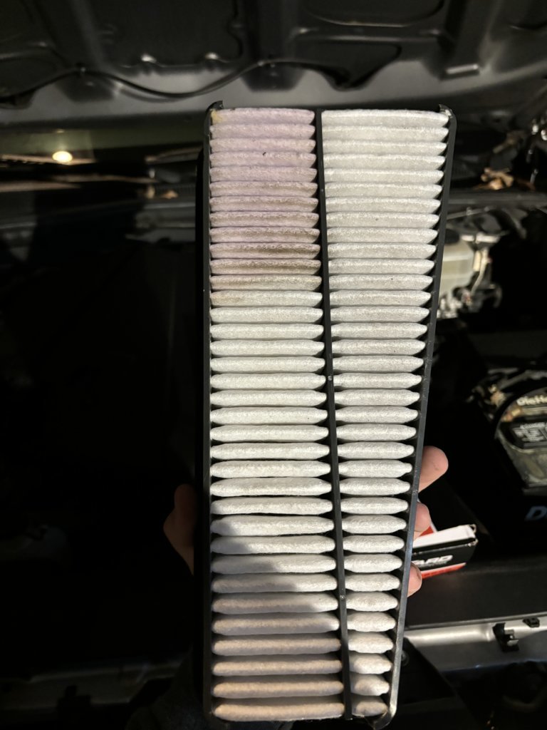

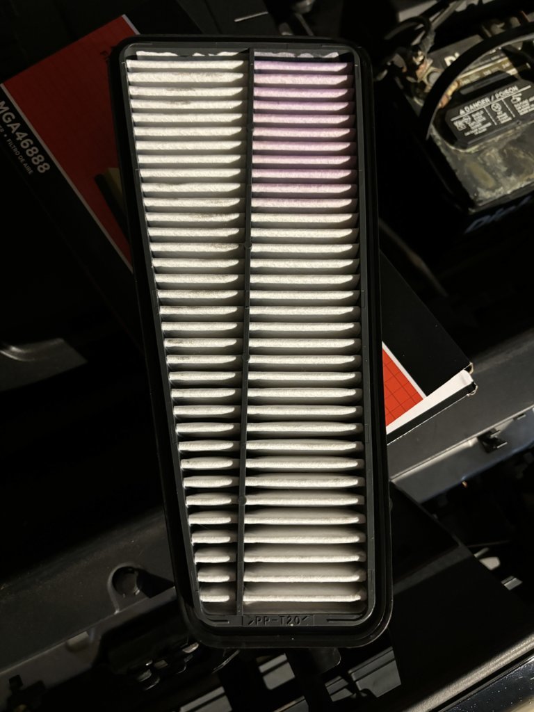

    IMG_5485.jpg IMG_5484.jpg IMG_5486.jpg I popped the air box open to change the filter and the old one has pink on it, I use dry filters.

    Did the vehicle previously have a K&N filter? Is there oil residue in the filter area. I do see some "wetness" where the filter seats.

    The existing filter is the first one I put on since buying the vehicle, do you think a previous filter would have left behind oil? I didn’t notice anything weird with the first filter.

    Looks like a stream coming in from the air tube.
    The air tube comes in from the fender. And the fender is open to outside air.
    But pink fluid from the fender / outside air? Kind of hard to explain.
    Unless it came from engine side of the intake?
    I guess you could pull the intake off at the throttle body and take a look.
    Get an idea of what direction the fluid came in from?

    I’m cleaning the throttle body this week so I can take a look, it does look like air filter oil but I think it would’ve shown on the air filter that had the oil in it? I changed the filter as well and cleaned the area so we will see if it comes back

    Pink could be either coolant or ATF. This could likely be either a coolant leak, or just an overflow from the expansion tank, drawn in through the air intake in the fender.

    The stuff stuck to the inside of the airbox looks like oil mist to me which isn't all that unusual considering how much oil some of these engines push into their PCV systems. The previous filter could have left behind oil (K&N AF oil is red) but I'd find that hard to believe it transferred from the old air filter to the a new one (in the middle of it's filtering surface). I'd wipe off the inside of the airbox with a clean paper towel and see if the residue inside the box is red also which would indicate its coming from the PCV system.
