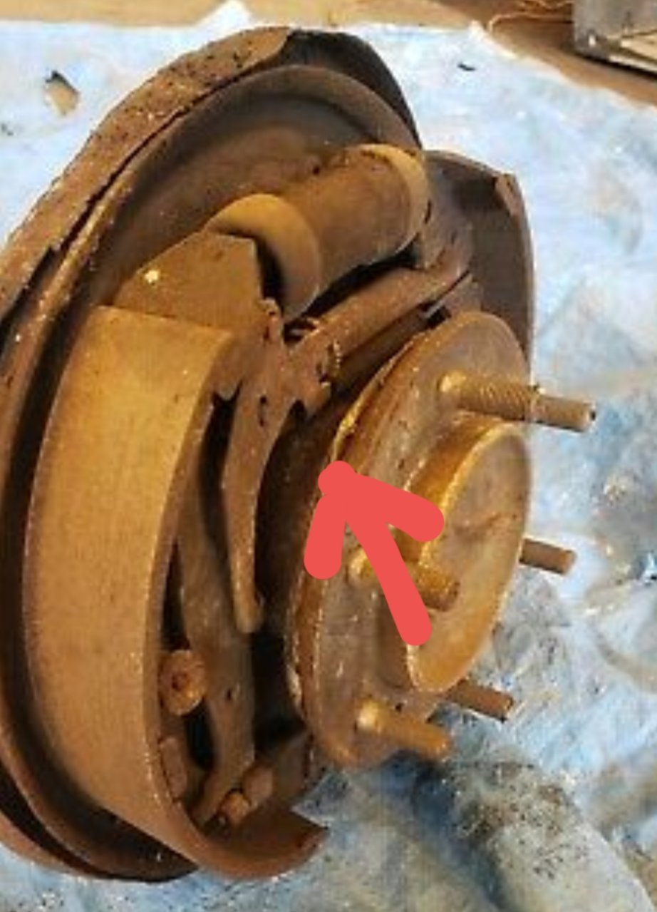

    Replacing all RR wheel studs, by using a wheel stud tool to press in with axle still installed
    There's a thin metal plate behind the axle flange that's preventing the studs from pressing in all the way. I can see about 1/8" of the splines of the wheel stud sticking out of the back side.
    What is this, and is it necessary or can I remove?
    Picture is not mine, from internet, but I put an arrow to show what I'm talking about.

    I can fit the studs in there no problem, they won't press in all the way. There is about 1/8" of the splines showing behind the axle flange.

    Not bottoming out, studs are aftermarket OE replacement, sizing them up they look the same. It seems like this thin plate behind the axle flange is the thing holding me up.

    No one knows what this thin plate is behind the axle flange?

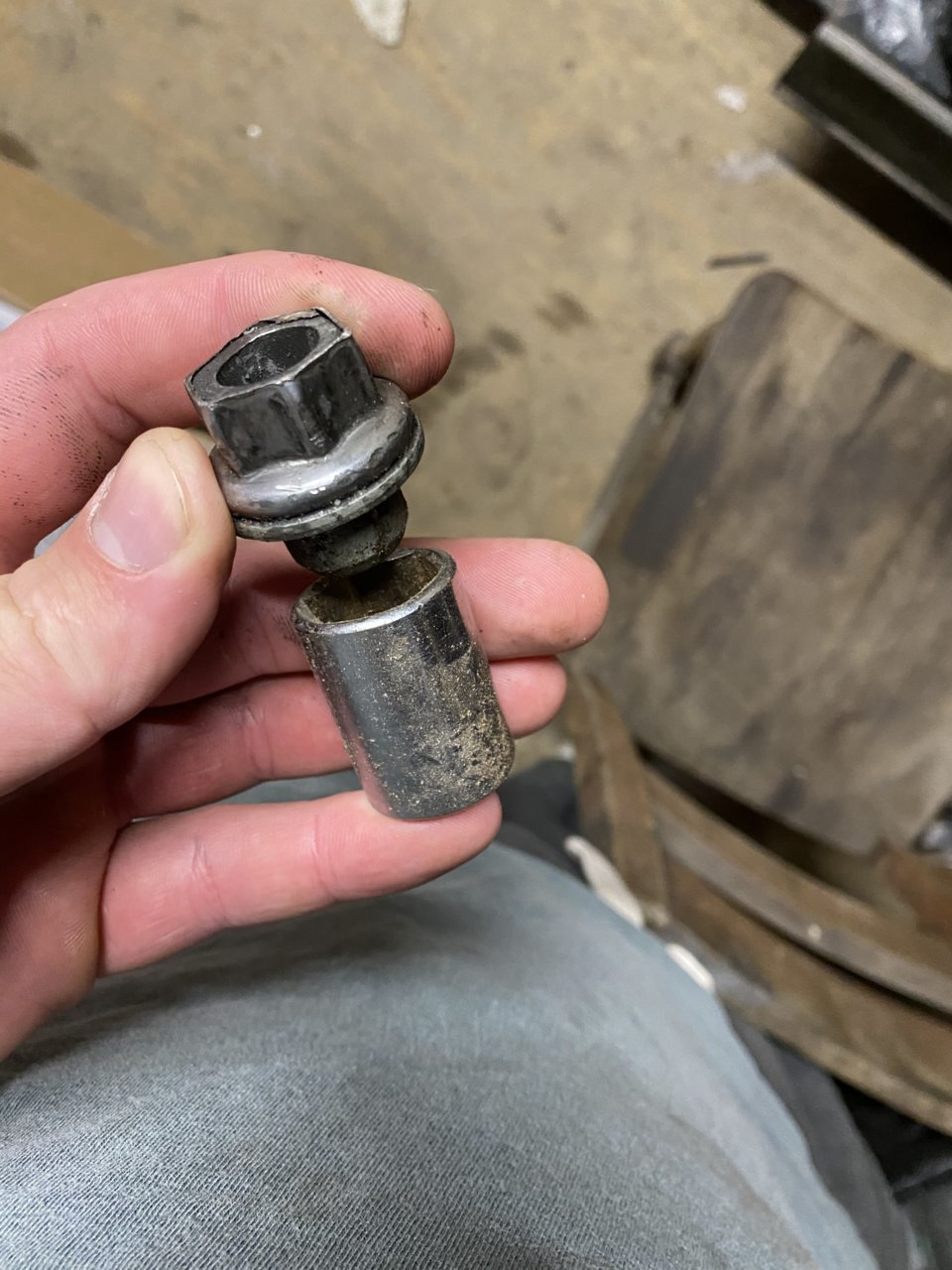

    I’ve used an old socket cut off to the right length and a lug nut with the end cut off. Had no prob pressing the studs in with that metal piece on the back

    It's the oil deflector. It shouldn't stop the studs from fully pressing in. They are meant to hold it in place. Post a pic so we might be able to better help.

    Have you used it yourself on the Tacoma? I tried the Lisle tool and the large hub register on the Tacoma doesn't leave enough room to use the tool. I just used a flat-faced open-ended Dorman lugnut to drive it in. Spray some lubricant on the splines and threads (but wipe the threads clean after).
