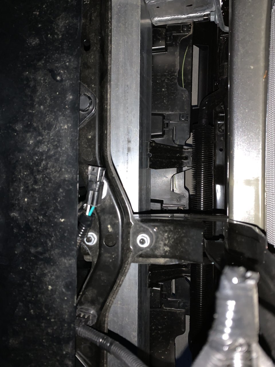

    2019 SR. Wonder what this plug is for?
    Point of view: looking down between the radiator and the grille; centered below the hood latch; near frame.

    Fog lights, maybe?

    Fogs?

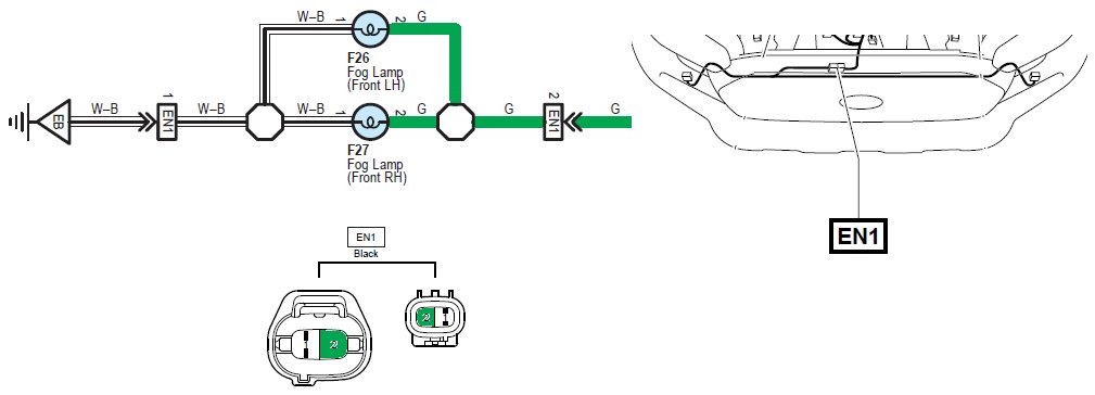

    Hood Struts, My version Fogs always ON, Map & Overhead Light Mod,
    Fog Lamp connector...

    Thanks; I read the thread attached. Assume I'm pre-wired then, right?

    Do you have factory keyless entry? If so, you more than likely have most of the wiring.

    I’m not sure. The best way to find out is use the directions in the above thread. If your not, it’s not a hard job to add the lights and wires. Plenty of people on here will give you good advice and help.
