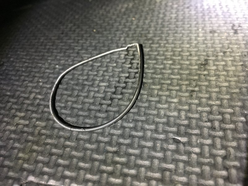

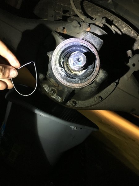

    So I'm wrestling with my rear pinion seal and this odd circular spring came out and I don't have a clue what it is and where it goes.

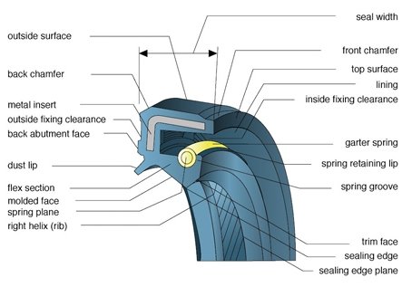

    It goes inside the seal itself. It helps the seal keep its shape. Not a re-use piece. New seal will have one.
