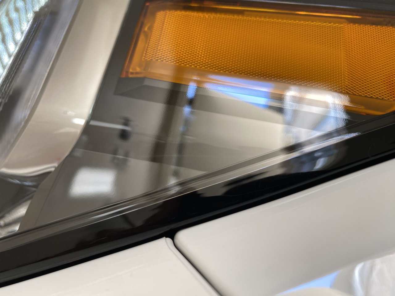

    Can anyone tell me what this speckled film/residue is on my truck? 1st pic is the bottom of divers side headlight- no residue.

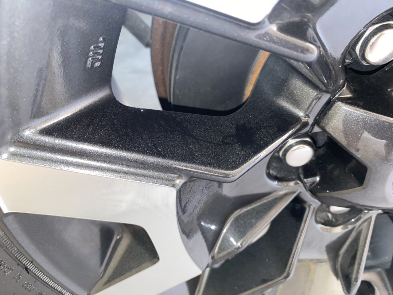

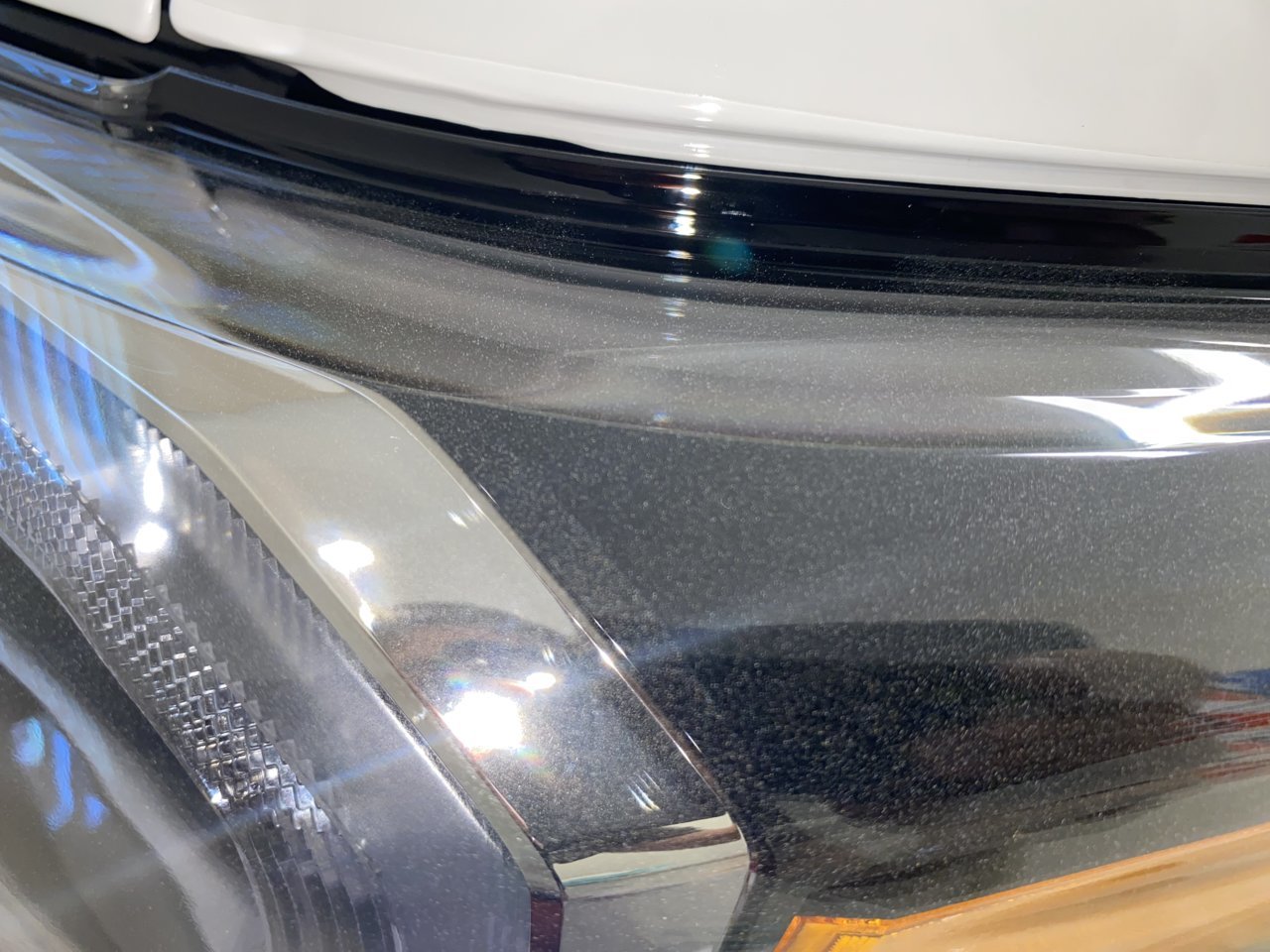

    2nd pic (look close) is the top of the same headlight- there appears to be some speckled film/residue on it. Same with the pic of a wheel. The pics were taken with the truck clean so it isn’t dust or dirt. The stuff won’t come off either.
    What is weird is that most of the body panels have it too although I can’t get it to show in pictures you can feel it if you rub your hand against it. Even more odd is that the top of the hood and some other body panels don’t have it- if you brush you hand along the top of the hood it feels like a normal body panel that is painted with clear coat- feels smooth. When I brush my hand against an affected area it feels rough, but is barely distinguishable from the rest of the body panel. But if I look close I can tell that the top of the hood was taped off before whatever this stuff is was applied.

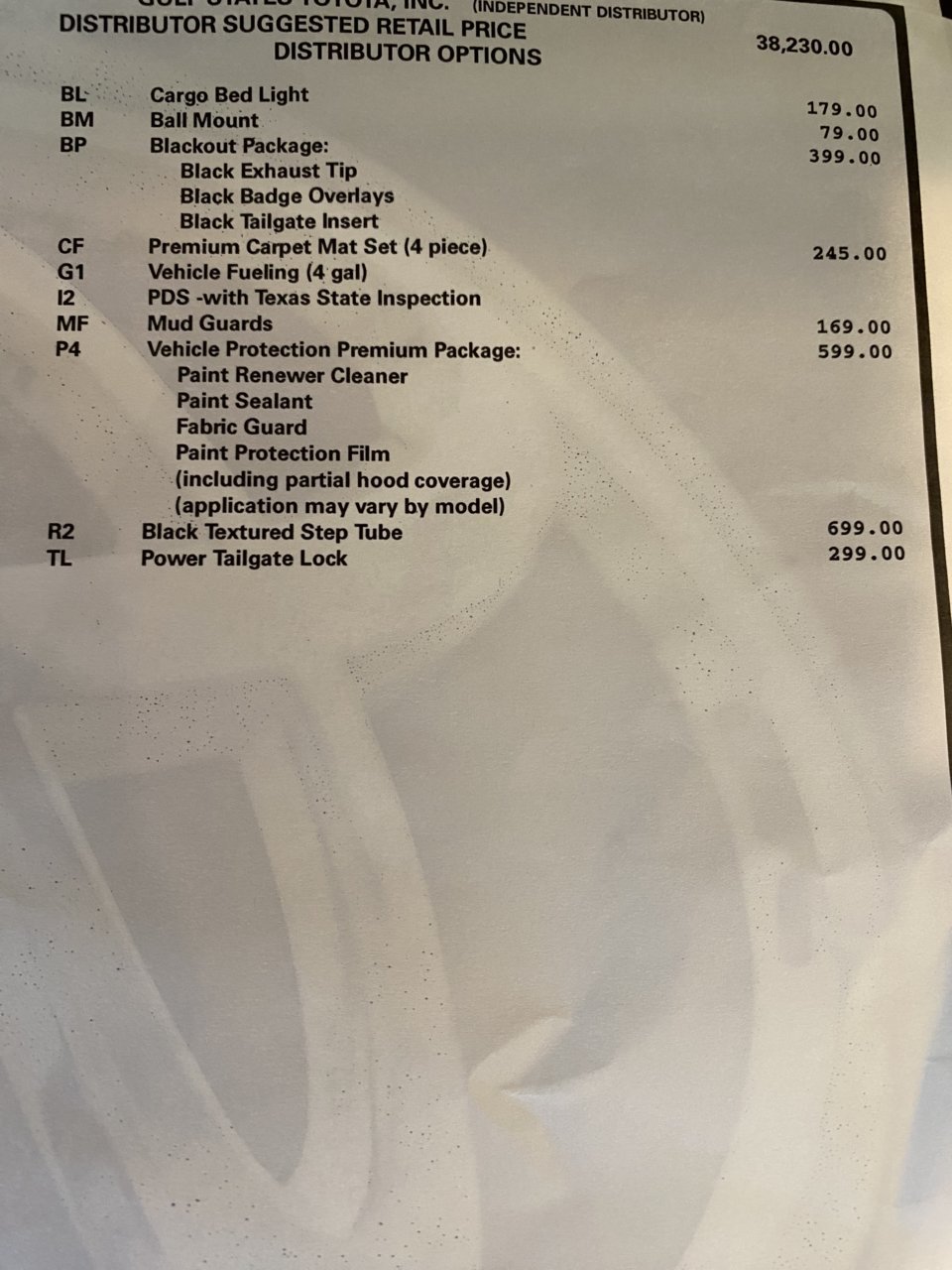

    My truck did come with the “Vehicle Protection Premium Package” so I’m wondering if they sprayed this stuff on and it got on other areas of the truck?
    My concern is that this stuff won’t come off, and I can see it on the windshield, back windows, trim, and of course the headlights and wheels.

    Did your dealer seriously charge you 80 bucks for a curt tow ball?

    Yep looks like overspray from the "sealant" (likely some kind of wax). It should come off after several months if you leave it alone. On glass you can try dish soap or an aggressive wax remover, but don't use it on paint or plastic.

    Try some mild cleaner polish on an area, I bet it removes it.

    Does the leading edge of the hood have an actual plastic/poly/vinyl film on it similar to a clear bug shield?
    If not they charged $599 for fuck all. Which might be slightly better than if they sprayed God knows what all over it.

    That looks like typical overspray. Do you park outside? Any neighbors recently had their house painted?

    I think you are correct about it being overspray. You think its ok if i leave it alone?
    Goo-gone works! (Well i have "Krud Killer" which is basically the same thing.) Tried it on a wheel and it seems to take it off where soap and water wouldn't (phew!)
    Did i look at the truck before i took delivery? Of course I did!! But i'm not rubbing my hands across all the body panels looking for paint texture inconsistencies. From 2 ft away truck looks clean and brand new, up close is only when you notice it (first world problems.) I honestly thought it was just a little dust and that it would be gone once i washed it.
    Dealer ghosting me. At the very least i want my dealer to fix affected areas or my $599 back. Will keep you updated.

    Yeah it has the clear vinyl film on certain areas like on the leading edge of the hood. Like most people who bought a new tacoma this year i couldn't say i don't want it. Had to come with that other crap including this paint sealant.
