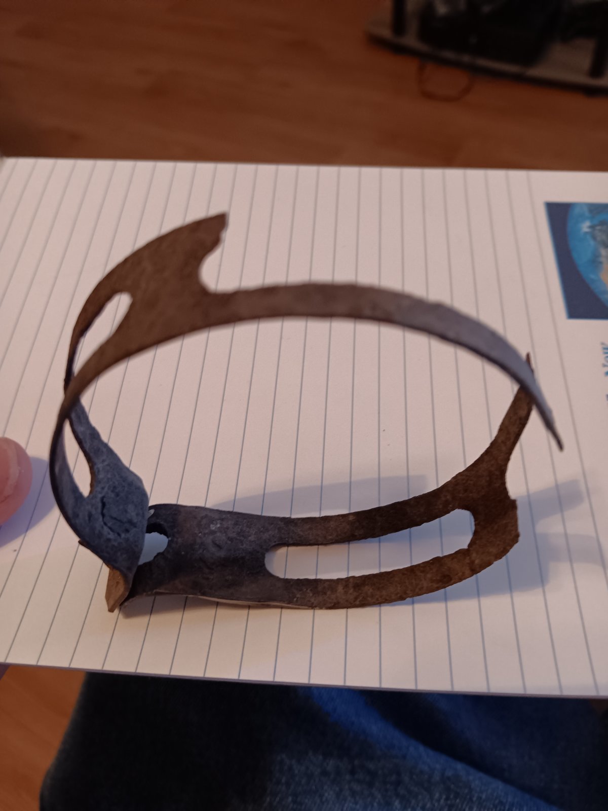

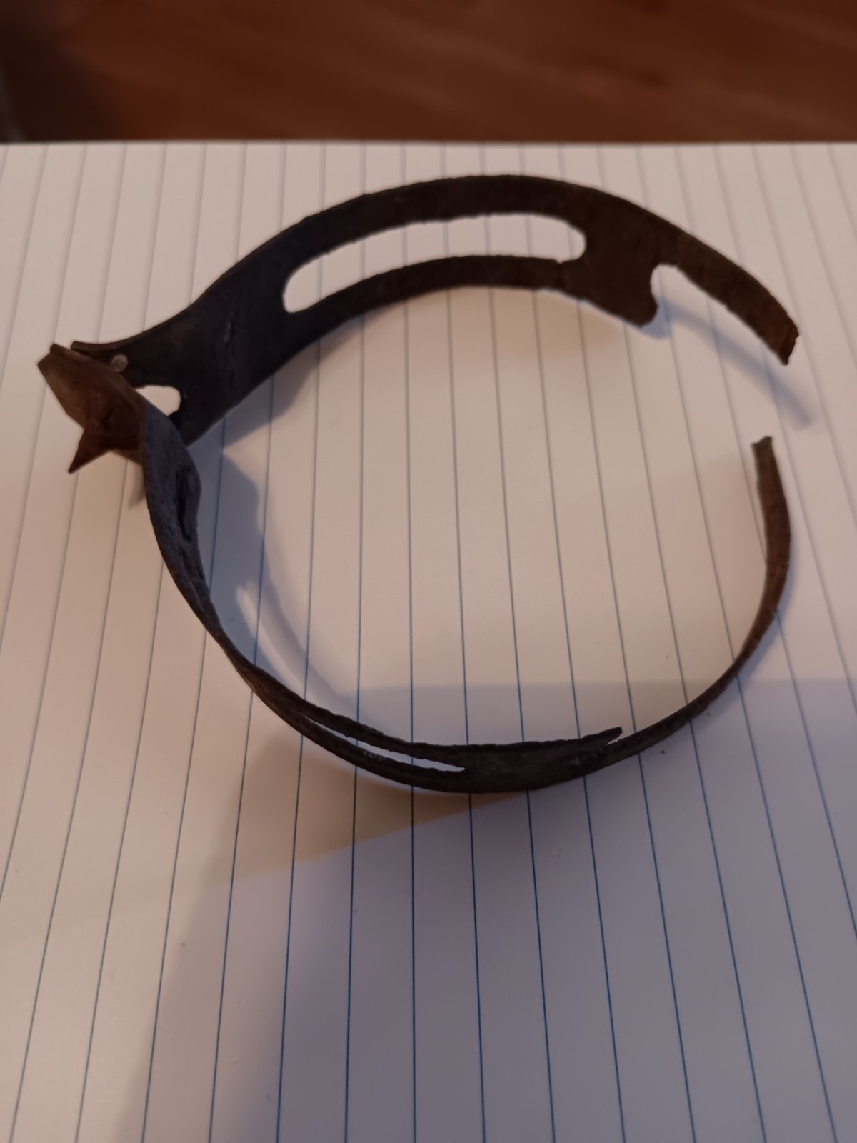

    So I was changing my oil this morning and saw this hanging down the pipe that comes off of the back of catalytic converter. I pulled it off because it is broken and was just hanging loosely on the pipe and can slide around on it . Is it just a band to hold on the heat shield ? I put a hose clamp around the heat shield 1 or 2 years ago when the bolts that hold it tight one rusted through and it was vibrating/rattling when I idled and it drove me nuts. It started recently doing it again so I thought the hose clamp just needed tightened up and saw this thing.20240225_125805.jpg 20240225_125743.jpg

    Looks like the OEM clamp that holds the cat heat shield on. If you already put a hose clamp on one side, this is probably the sign you need a 2nd one on the other end.

    I cheaped out and only put one hose clamp in the middle but I'm guessing 2 would work better and not let the ends wiggle/vibrate so much.

    I found the same thing (rusted out clamp) hanging on to the pipe near the cat. I assume it secured the heat shield which is missing. For the quality reputation they have, Toyota sure uses some awfully crappy parts in their vehicles, especially clamps and brackets. It's strange because under the hood and under the truck, 50% are a mess (rust) and the other half look fine.

    I've had it in Toyota dealer in Texas twice and passed no problems. They don't do emissions here so maybe they aren't looking at that and it isn't like a dealership to not recommend fixing something if they can make a buck. The hose clamp and shield are still on good I double checked them before I took it for a short ride today the rattle is gone so I'm thinking the loose clip was what was doing it. You guys are always helpful on here.:)
