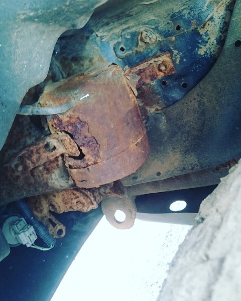

    Ok so I am new and I'm sure there is a post on this but I don't know where to look
    Location: in front of drivers side front tire, behind front bumper left side
    I googled vacuum tank, reservoir, canister...got nothing

    Sorry, thought the pic uploaded. Uploading now

    What is it for?

    Whatever it was for it's probably not doing it anymore. Pretty sure that wasn't put on by the factory.

    Vacuum tank. Plug the line. As now youve got a vacuum leak.
    And holy rusty. Whats rest of truck look like?

    So it's stock or not? Can't find anything online that looks similar to it...rest of truck is fine actually

    Yes its factory. I believe it "stores" vacuum on earlier models with vacuum operated 4x4 systems.
