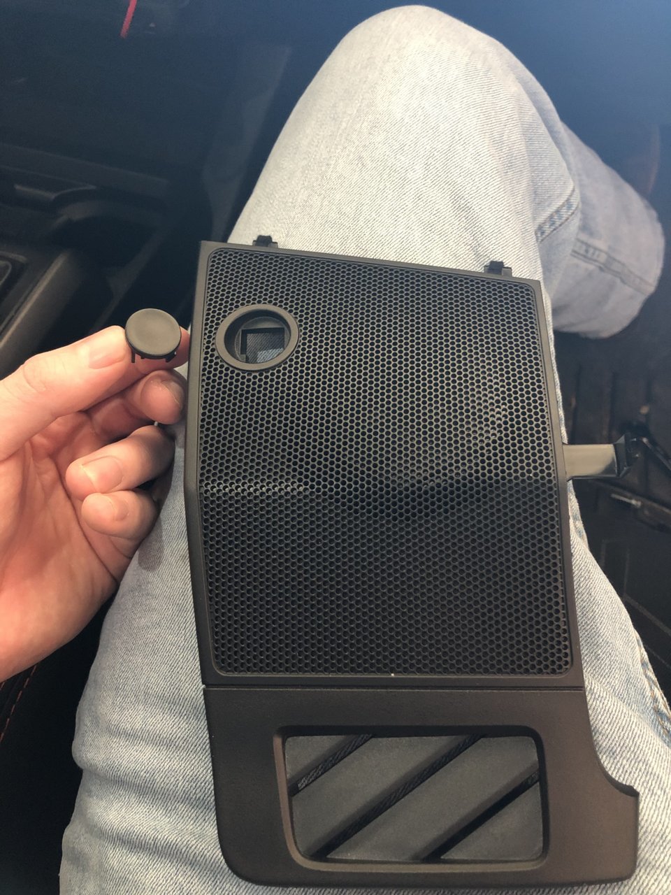

    What is this? It’s on the tweeter cover on the passenger side. I have been hearing an annoying rattle from here recently so I took it all apart to see if something was loose and this was loose. It’s clipped in to the cover but not tightly. Is it something that I can just take off or glue on so it doesn’t rattle?E152CC81-C67C-489F-8517-91EFC39835C4.jpg

    If you had auto headlights the sensor would be where that plug is.

    Ohhhhhh. That makes sense. I was thinking some sort of thermostat. I didn’t know Tacoma’s had auto lights.

    Try slipping some type of thin malleable shim on one or more of the clips or under a corner of the housing cowel to tighten up the gap or the clips in hopes of addressing the rattle. Or crank the volume up.

    I just popped it out. I’m gonna drive like that for a while to see if that is it. If so I’ll probably just leave it out. Doesn’t seem to hurt anything. Maybe I’ll try to figure out how to get auto lights

    Mine rattled like a SOB too. I put a couple slivers of electrical tape beneath it and snapped it back it. No rattles since.

    Lol that’s really specific. But I get what you’re saying. Good call. I’ll tape it like the other fella was saying.

    1. Unbolt the passenger grab handle on the A pillar.
    2. Pull off the plastic trim from the A pillar.
    3. Lift the speaker cover out of the dash.
    Plastic auto trim removal tools are very handy for this.
    Search for the tweeter upgrade thread and you can see pics of the removal.
