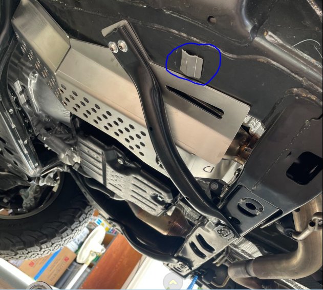

    Hey guys,
    First post here and I'll upload a pic of my taco soon. I'm stealing a picture I found on the Cali Raised cat shield thread. Can somebody help me understand what this plastic piece is all about? I came across this piece when I inspected my cat and noticed that it looked broken and can be easily removed. It does not appear to have any functional value whatsoever. If not obvious, it's located near the catalytic converter area.
    Any thoughts?
    Thanks

    Aprilia Tuareg 660
    They’re supposed to help seal the holes in the frame to prevent water/salt/debris from getting in there and rusting it out. Toyota’s cheap way to get around 30 years of frame rot rather than building it out of properly treated metal.

    17" Black TRD rims Tacoma Stainless Steel Rear Tailgate Letter Inserts Brake light flasher Center LED 110v and 2-3amp USB plugs mod in back seat center 400w on all the time mod SSR-610-40 SumoSprings 32 INCH 180W CREE LIGHT BAR (5D ) AUXBEAM BedStep and Pop & Lock Power Tailgate Lock Blue LED glove box light (fix no light) Bed light Blue LED's Wired to turn on when Gate is opened Tempered Glass Center Touch Screen Protector Rear Camera anytime Navigation Bypass ( a must) Rexing V1 3rd Generation Dash Cam hard wired in OXILAM 912 921 LED Reverse Light 2000 Lumens TRD Pro Grill TRD Skid plate
    It covers holes so water can drip out but also stops stuff from spraying in. It's to help the frame not rust.... (as fast)

    Both responses makes the explanation unanimous. :thumbsup:
    I find it weird that the part doesn't seem to have a firm fit and it's rough edges makes it seem that something broke. Nevertheless, I'll leave them 'as is'.
    Thanks!
    Yep they were added for a TSB on my 2016 and standard after 2018? 2019?

    2023 TRD Off Road DCSB Lunar Rock
    They are located in the same spot that you lift the truck from so they usually get crushed and broken like yours. I ripped mine out when I found them broken - the way they are shaped doesn’t allow easy removal. I can see Toyotas thought by adding them, but if they are broken and collapsed like that I fear they have the potential to clog the hole and do more hard them good.

    2024 SR5 DCSB 4WD
    I snapped off one of those using a jack to do tire rotations long ago. Happened to my '09, '21, and current '22... :anonymous:

    19' Limited 4x4 (01' TRD OR, 97’ SR5 V6, 88’ SR5 Extra Cab)
    I’ve been told (by a Toyota tech on this forum) those are put there to indicate if the truck has been put on a lift.

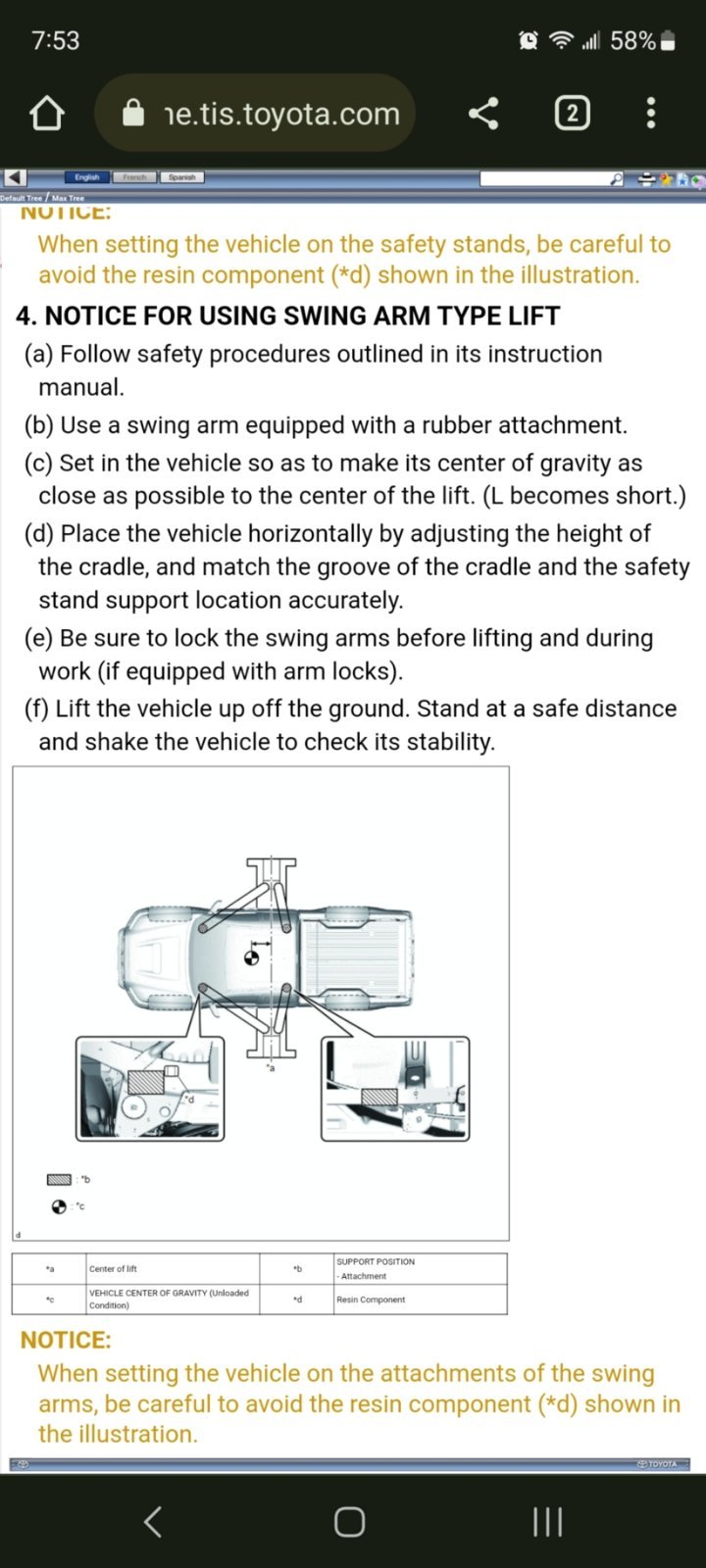

    2023 Celestial Silver Off Road
    Everyone always crushes them, but per Toyota lift instructions it specifically says to avoid them when placing on a lift. They're referred to in this doc as the resin components.

    12,152
    It's just a plug for the frame, its a poor design and I've seen them broken when the truck is new.
    We replaced them during frame replacement and frame sprays.
