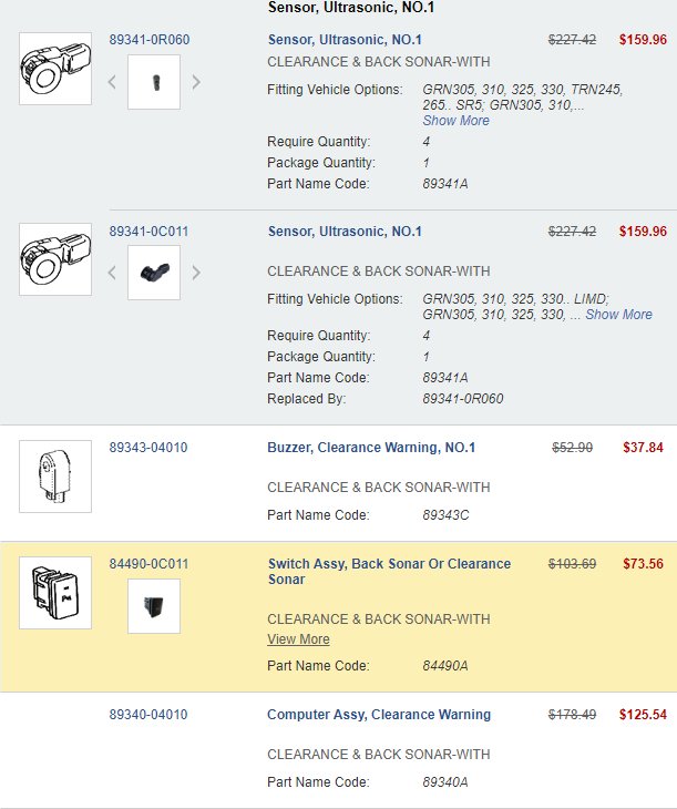

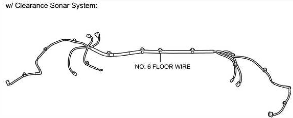

    Any idea if this is possible to add this feature to the truck as it is a non factory option for the Canadian sport trim? This hardware being present make things easier, no?
  5. Jan 22, 2023 at 5:34 AM
    #25
    caribe makaira
    caribe makaira Well-Known Member
    Feb 13, 2011
    #51121
    11,809
    Caribbean, Puerto Rico
    05 PreRunner TRD Offroad AutoTrans
    Hood Struts, My version Fogs always ON, Map & Overhead Light Mod,
    Its most likely a cost prohibitive issue;
    Sensors (x4)
    Harness to sensors
    ECU
    Bolts to secure ECU
    Switch
    Buzzer
    Disassembly n assembly of dash
    Programing
    But if you have the $$$...

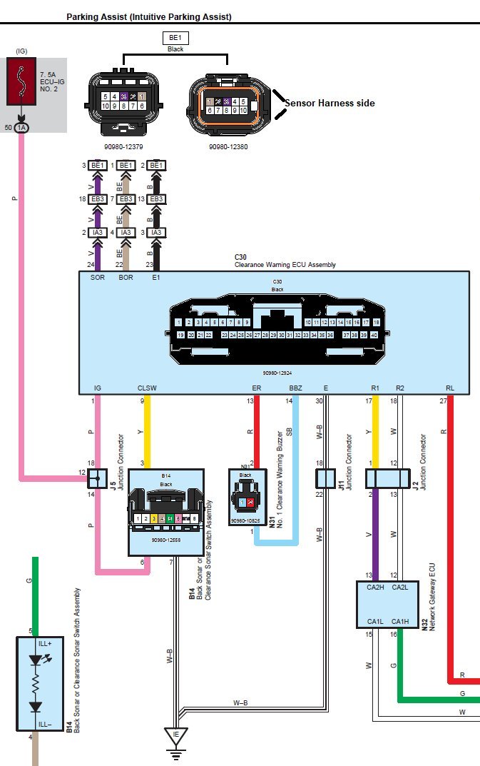

    Full circuit:
    Connectors you may have and need to be completed (ECU, SENSORS, Buzzer, Switch)

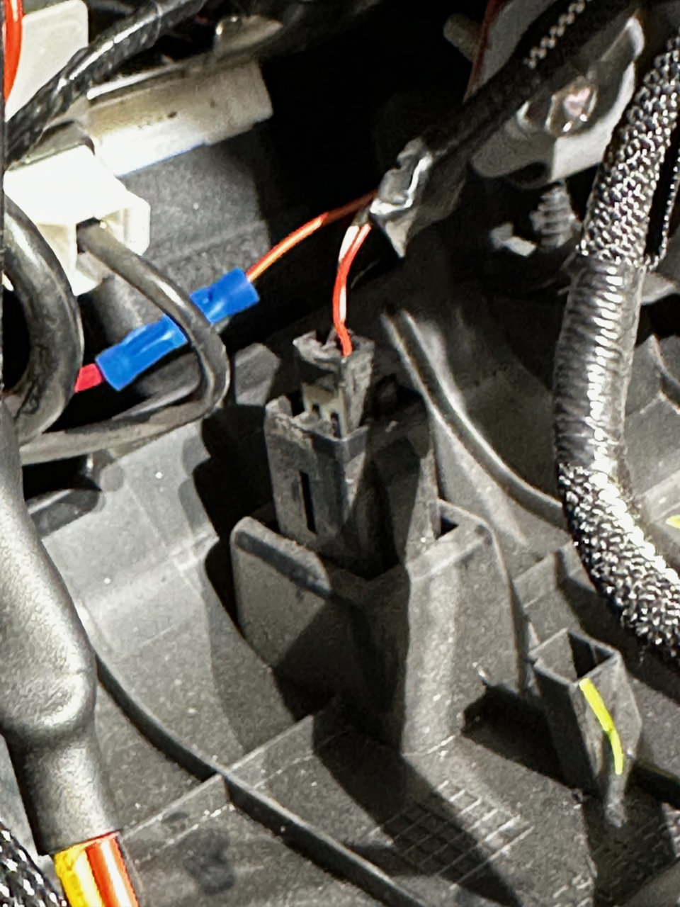

    This weekend I installed the anytime camera on my 22 off road (with the parking sonar system) and noticed a black harness that was not being used when I took the head unit out. I was curious about this and searched a bit and came to this post. I should have taken a picture of the harness but I did not, however it is not plugged into anything and my parking sensors are working just fine as I just checked. Maybe I was not looking at the same harness, is there another unused one that would be back there? Next time I have the head unit out I will look at it and get a picture of it

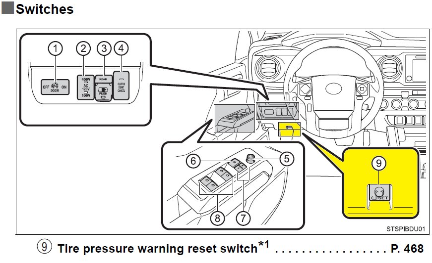

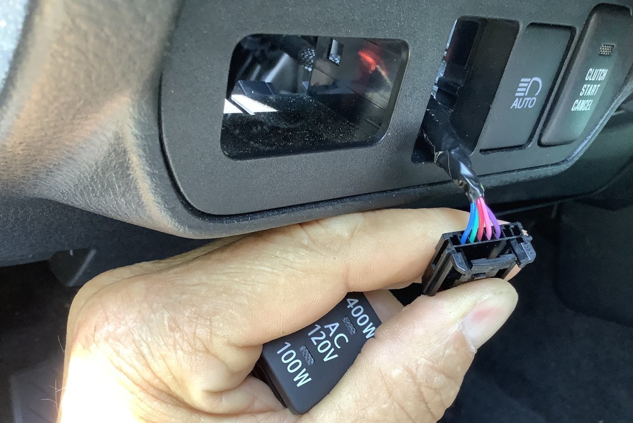

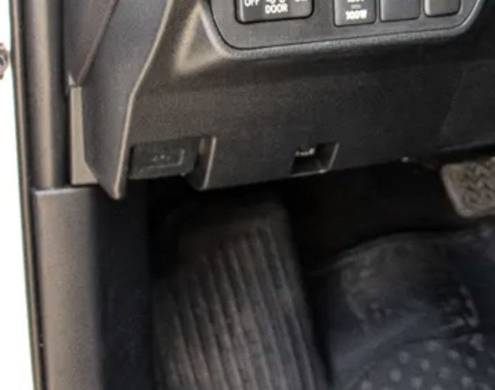

    Still haven't haven't gotten to the lens yet but I did notice this other "wired but blank switch" on the drivers side? below the pocket switches/near the fuse panel
    from rear
    its that little divot at the bottom there to the right of the hood release

  14. Feb 12, 2023 at 11:34 AM

    well that would explain why its blank for me haha also why few other people are wondering what it is. thanks again!

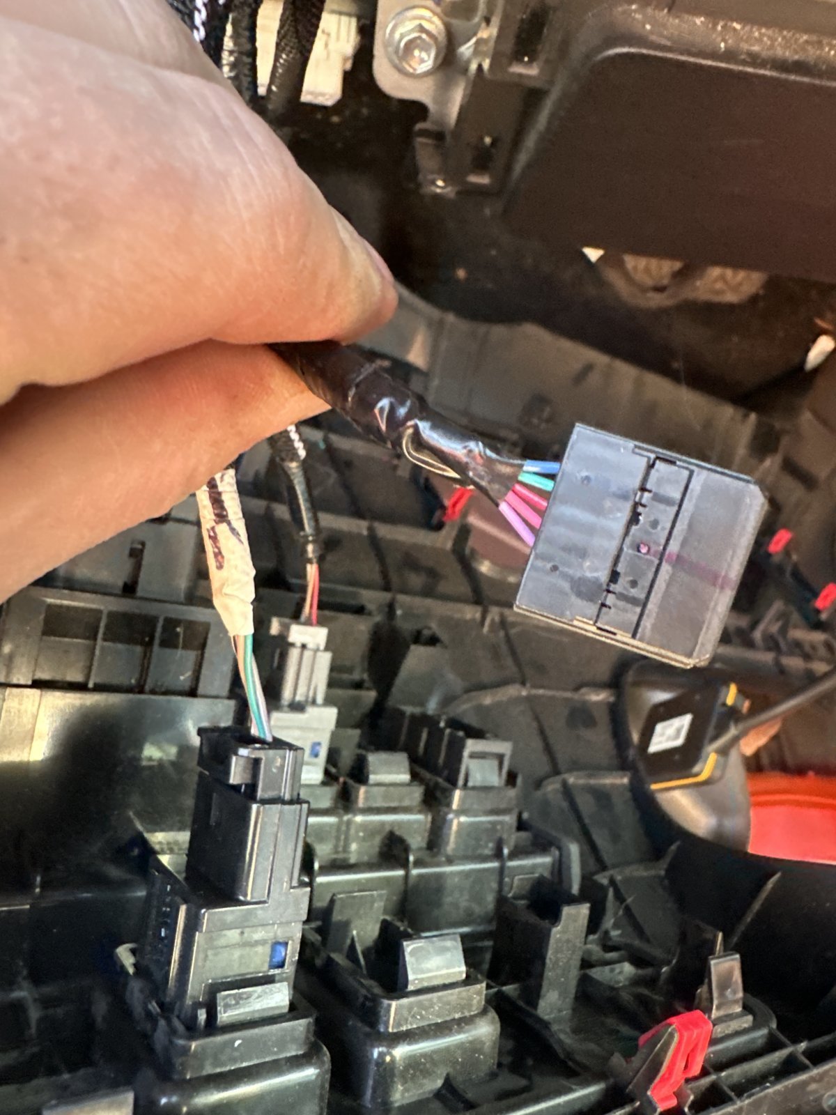

    I was installing a remote start system in my 2021 and I found this plug is it unused or did I get unplugged from somewhere?

    Inverter control switch connector.
