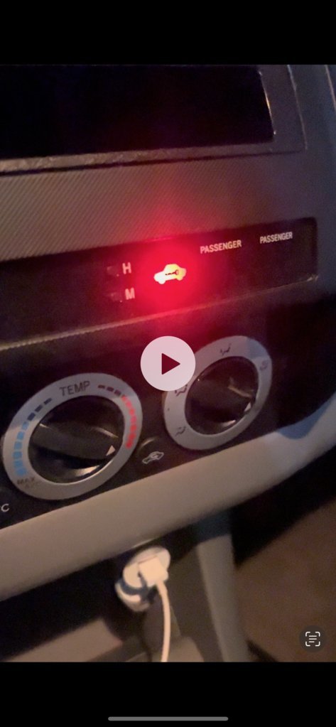

    My daughter is 500 miles away and is getting a warning light on the dash of her 2011 Tacoma. I can't find anything on the web that looks like the warning light. What does it mean?

    That's the alarm/security system. What symptom is your daughter seeing? Truck not starting?

    Thanks for the info. She said it blinked a few times and stopped and hasn't returned. Otherwise, no issues. I'll try and get more info on the circumstances, but I wasn't aware of a security/alarm system on the vehicle.

    Just a guess but I had my work bag on the passenger seat shortly after I got my truck. Disabled the air bag & the light quit warning me.

    The key should have some sort of chip inside it. That's why the keys have to be programmed if you buy a replacement. Actually, it's probably the truck itself that needs programmed. I've had a couple done at ACE hardware.
    That light though, that's perfectly normal.
    https://www.tacomaworld.com/threads/whats-the-red-blinking-car-with-key-icon.450784/#post-13215860:
    "It's the Engine Immobilizer System, toyotas anti-theft system once u insert the key into the ignition the transponder on the key sends a signal to the system to shut off allowing you to turn on the engine. Without the right key to match the signal the engine wont turn on. It turns on automatically after you remove the key."

    I believe it blinks for a minute or so when first unlocking and entering vehicle

    Toyota OEM Engine Immobilizer Anti-Theft system indicator lamp. On my 2014, the light starts blinking when I remove the key and stops when I insert the key and regardless of door position or lock status.

    Umm.....I could be wrong, but I think that light means that you disabled the airbag on the passenger seat. You can do that with your key. They have that provision in case you have a kid or small adult sitting there. The light is to remind you to turn it back on for normal sized adults. I love it because it's very visible at night, and looks like you have an alarm system armed.

    No, the airbag light is different.
    That is the immobilizer light.
    It should stop flashing with the key in the ignition.
    And it should start flashing again once the key is taken out of the ignition.

    TN, I was so convinced, I had to go out and try it. You are right (mostly). The light goes out when you turn the key to RUN. It flashes in the ACC position and the OFF position. The airbag lights are separate. I've been wrong about this for..., let's see... 14 years!

    Mine comes on for about 3 seconds once the key is in the ignition.
    Then goes off. I don't have to turn the key at all.
    When you insert the key in the ignition, does the ignition beep?
    The warning beeper to tell you the key is in the ignition?
    If not, your key may be worn.
    My old key was so worn it wouldn't even unlock the door.
    Once I got a new key, the warning beeper started working again.
    The immobilizer light also went off too. Without having to turn the key.
